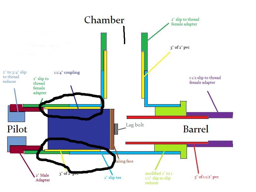

By far the largest component of the loading here is the impact of the piston into the housing when the valve opens. Assuming 1" of piston travel and a vacuum behind the piston, the impact force would generate an axial stress in the housing on the order of 6kpsi, similar to the tensile strength (roughly twice that where the two sleeving sections meet and there is effectively only one layer). This does not happen in reality because the pressure on the pilot side of the piston is substantially different from zero, but it is generally the case that piston valves fail on opening due to the impact load.

2014-08-15T15:13:18-05:00 2014-08-15T15:13:18-05:00 https://www.spudfiles.com/viewtopic.php?t=25960&p=377521#p377521 <![CDATA[Question about piston valve]]> I am in the process of making a piston valve in a three inch tee. I have everything I need, except the 3" PVC I have for the part circled in the attached photo it DWV PVC. I know that using it for a chamber is a big no-no, but would it be OK to use for the part I circled? It shouldn't have any pressure since it will be inside the coupler and tee, but it will have tensile force. (I believe it is tensile). Thanks for any help
