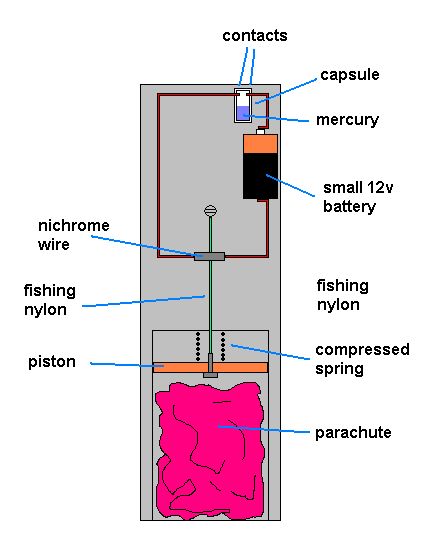

How about an electronically fired device (say a hot wire that burns through a string holding down a spring-loaded parachute) that is triggered by a losse piece of mercury in a tube that closes the circuit the minute the trajectory goes from up to down, technically at the peak.

Stay with me, have a look at the diagram - it's a bit complicated to make but not really when you think about it, does it make more sense now?

Makes much sense, however i can't get mercury.
I like the idea, i just need a different trigger mech.
We are also limited by our 18mm rounds :?
Edit- how about a bb as the contact? I would have to weight the round nice but...

Novacastrian wrote:Makes much sense, however i can't get mercury
Break a thermometer ;) though a BB will do nicely as long as it reliably touches both contacts.
You do have a point though, 18mm is a bit tight for this sort of mechanism.

Instead of making your own little capsule to hold the mercury, why not go to an electronics shop and get yourself one of these? They only cost a dollar or so.

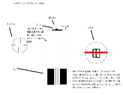

Here's my design for a parachute (or any payload really) ammo. Spudblaster15 built it and it worked, but the rubber bands he used on it were too strong so to get it to work he had to remove them.
Larger fins would eliminate this problem.
EDIT: I think I may have found a flaw in your design jack. If the air resistance on the projectile is too great, then it may decelarate enough for the mercury to experience negative G's, making it rise to the top of the little tube it is in, and set off the parachute. If this happens making the ammo more aerodynamic might help.
