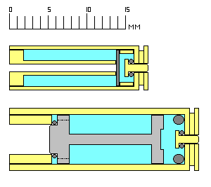

al-xg wrote:Mmhmm and how does it get to the O-ring in the first place ? Loose fitting pump shaft ?
Yep - no o-rings see?
And the pin moves back with pressure on first pump stroke?
That's the idea, given close tolerances for good fit but low friction, everything should click into place with the first stroke.
Also, this will probably not be built. I'm thinking more along the lines of small, small cartridges ;)

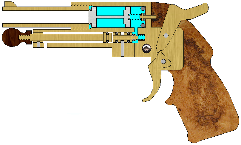

Trigger and hammer shown mid-cycle, not shown are two torsion springs, one to operate the hammer and one to return the trigger to its rest position

:lol:
That's more like it.
15mm ? :roll:
The 25mm one makes slightly more sense... 30mm might just start being useful :)
