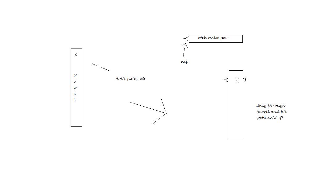

would this be faster and re-usable
etch res pen method
etch res pen method
etch r barrel dwl.jpg (19.75 KiB) Viewed 6577 times

I don't think this will work very well at all. Coating the surface of the metal with wax will not prevent an acid solution from attacking the underlying material.
I got some good results with just masking tape here.

It's hard to tell from the picture but how deep are the markings ?
This works well with lead slugs and it's not particularly deep. The main reason is that It'd require a thicker barrel...
Mon Dec 12, 2011 12:42 am
Ah yes...
al-xg wrote:This works well with lead slugs and it's not particularly deep. The main reason is that It'd require a thicker barrel...
I don't expect acid to etch much deeper, but surely 12 grooves instead of 6 would be more effective :)
