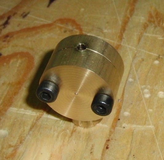

Might be the lighting, but I can't tell for sure if that's brass or aluminum...aluminum would be the better.
Will have to add some venting...small grooves running from the mold cavity to the edge...to allow the air to get out. Divot at the fill to act as a funnel will help too.
Will suggest you add some taper to the section that forms the inside of the skirt as well....a couple degrees is plenty (iirc I used 5). Will make removal a HECK of a lot easier.
Mold will need to be HOT to fill the skirt nicely.
Brass. Should work though, right?Gippeto wrote:Might be the lighting, but I can't tell for sure if that's brass or aluminum...aluminum would be the better.
Quick MS Paint scribble of where you would do it?Will have to add some venting...small grooves running from the mold cavity to the edge...to allow the air to get out.
Added it after I took the picturesDivot at the fill to act as a funnel will help too.
I was thinking about that, will do.Will suggest you add some taper to the section that forms the inside of the skirt as well....a couple degrees is plenty (iirc I used 5). Will make removal a HECK of a lot easier.
That will be jake's problem, but given his sharpness workshop he shouldn't find that an issueMold will need to be HOT to fill the skirt nicely.

Brass will work...but mold release will be important...hot lead WILL bond to hot brass surprisingly well... if given an opportunity.
Smoking the mold with a sulphur match might work...this is how the old cast iron molds were prepped. There are also commercially available release compounds that might work.
Vents should be spaced about every 3mm of the projectile height. Don't need to be deep, .005"-.010" has proven adequate. Make them on both sides of the cavity.
I suspect Jake CAN indeed get it hot enough.
So basically... scratches?Gippeto wrote:Don't need to be deep, .005"-.010" has proven adequate. Make them on both sides of the cavity.

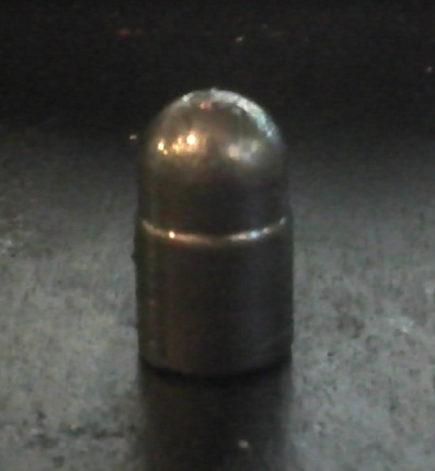

That seems to have turned out pretty well
It seems to have some stability issues though, maybe the wall thickness of the cavity is too much.
