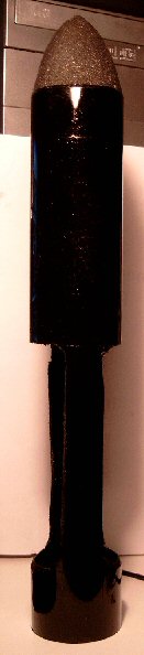

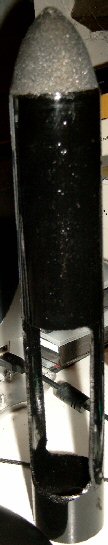

For those who have a 50 mm barrel, you could make a arrow like this one. It is constructed of PVC. The end works as a flight stabilisator. Inside the endring I 'm gonne construct some PET vins in a twisted way, so in flight, the arrow starts to spin, so the ammo flighs more accurate.
The nose cone os the arrow is constructed out of hard isolating foam, 5 cm (2") thick. I putted a piece on a big screw, and put the srew in a dril, and let it turn slowly (relatively slowly) like a improvices lathe. With a file and sandpaper I then formed the nose cone like it is. The cone is then glued in the pipe with ordinary PVC-glue.
There is a hollow space in it, between the tail and the nose cone. You should put things in it to give it a bir of weight, like forinstance a smoke bomb or so.
You can also put is a pressurized water rocket, so when you shoot it, the pressure releases and gives the rocket extra power and speed. The rocket can be equiped wits a parachute that opens on apogee.
Anyway, her's the rocket or arrow :
Sideway of the rocket. good sight of the nosecone and the stabilizor
Clear sight on the stabilizer

Nice rocket, how accurate is it and does it go far?

I 'm gonne test it, hasn't been done for the moment. I 'm going to buy some pressure PVC next month, I have to drive 90 km for that. When I have my gun ready, I let you nof for sure. It is pressty light. According to the GGDT, with a bit of payload, the arrow should fly over 1000 feet.
I dont doubt the fact that it is acurate, since it has a stabiliser and it will spin in midair. I have experience with waterrockets, they are pretty acurate with stabilisers and spinning.

what size is the pvc? I make my rockets out of aluminum pipe, steel nosecones, and flexible tail fins made from bucket lids.

The PVC is 50 mm. But I plan to build a 43 mm barreled pneumatic, so I have to take an other pipe.
What size are your darts ? And what is the use of them ? I make them out of PVC, so they are extra light. The arrow you see up there waighs exacly 100 gram. So room enough for a payload like a smokebomb or something. That should be nice in midair.
