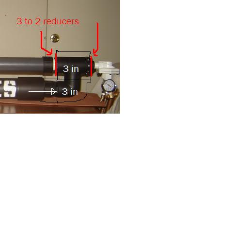

Mon May 31, 2010 11:20 pm
Slauma wrote:
@Tech
I'm having a little bit of trouble picturing what you're talking about. Think you could whip up a diagram? Visuals seriously help me, you should see all the little sketches on all the random bits of paper scattered about my desk
OK. It's quick as I just used Paint at work. I miss the Gimp here.. :(
Beef up the elbow indicated with 3 inch to the valve and beef up the valve to a 3 inch shell using a large T. Use the reducers to build the 2 inch valve inside. Flow is now unrestricted from the chamber to the valve. :D
Now the chamber bends full size right into the piston. The elbow and T become part of the chamber.
3 inch mod.  It can be done with 4 inch if desired.
