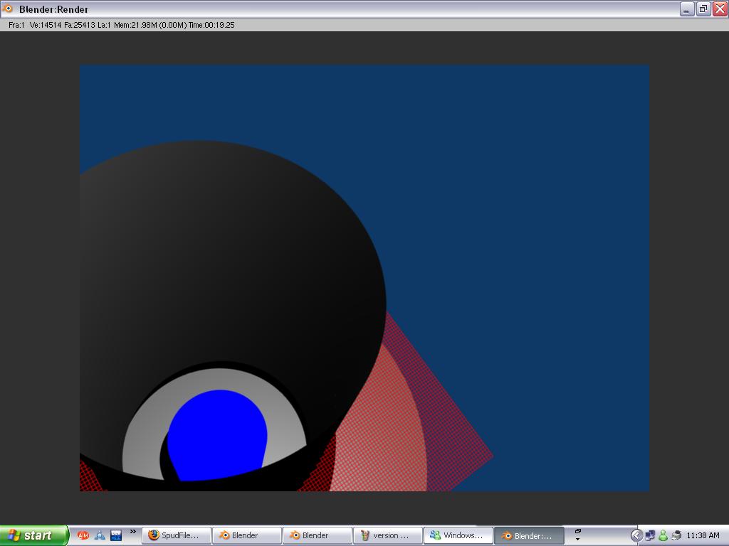

ok, lately ive been thinking of making an electrolysis machine, and ive been trying to think of ways to make it faster or more efficient. I would like input on which ones will work, and for the ones that work, which one would be the most efficient.
in the pics the things are kinda color coded:
the blue and red are the opposite electrodes
and white or grey is pipe
and dont yell at me for bad pics as i only had bout 20 min to make all three
and imagine that this all is inside a container
