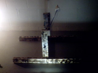

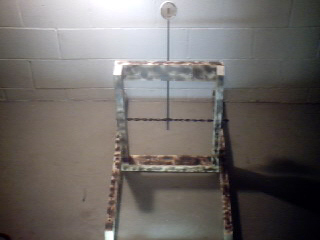

I had to make this for my senior project. I goes pretty good its made out of wood rope a fiberglass arm and a pvc screw cap as the basket here is a vid

Ok, i like the simplicity however in the vid it seemed a little under powered.
I voted bigger would be better- most things are, except women :P
Any idea on the draw weight? Oh and weight of projectiles?

well in the video the projectile was a snowball and it went 20 feet and hit a wall

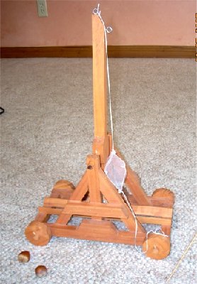

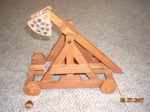

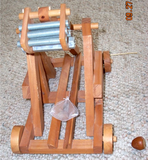

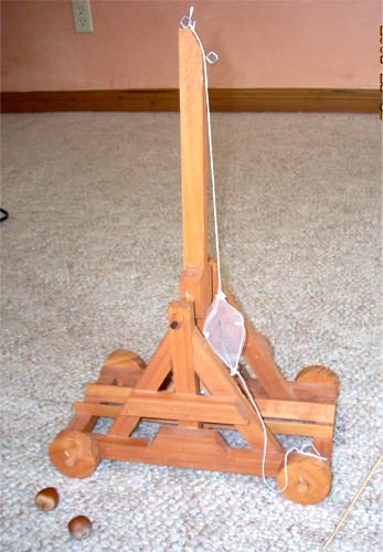

Here's my mini treb.
Knocked it together one day based on a single online photo. My WAG's at the various dimensions were way off, the main towers should have been twice as tall, the throwing arm longer etc. Throws nuts.
Locked and loaded. The thin stick on the right is the trigger.

iknowmy3tables wrote:wow that mini is sweet jimmy I could almost swear that it's a hobby building kit or something that you bought
Thanks.
The wood was just something like 1/2"x3/4" trim wood, nice straight stuff comes planed smooth, from the hardware store. But, everything I used I had laying the garage already.
The wheels are just slices out of a big-ass dowel. The axles are standard dowels (1/4"?). The pins that hold the various axles in place are pieces of toothpicks. The weights are hunks of 3/8" allthread.
I've got a nice compound sliding miter saw so chopping the pieces was simple.
It is glued and finish nailed together (I have a small pneumatic finish nailer).
Slapped a quick coat of wood stain on it.
