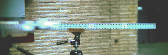

Yes. Allow for parallax error and include a measure in the shot like this.
Video was used to confirm the chronograph results to eliminate possible muzzle blast errors for close to the muzzle clocking of projectiles that rapidly slow upon exit. Measured results were confirmed.

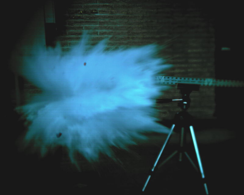

Slow motion video clocking a t shirt in flight.

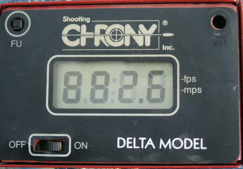

Chronograph results for a launched apple.
