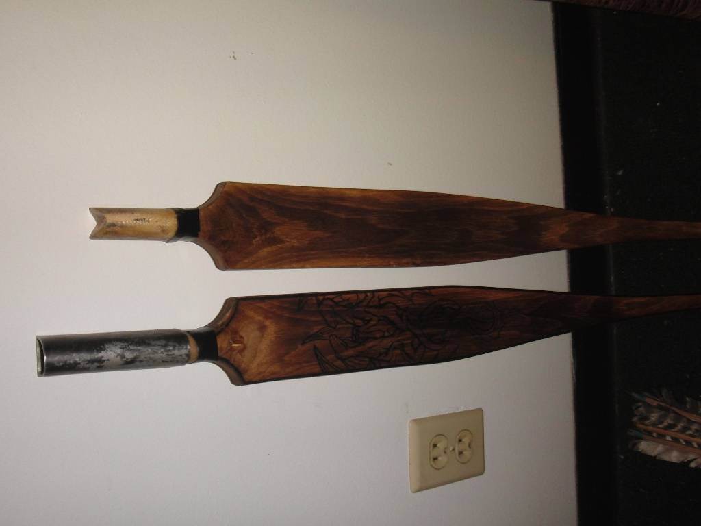

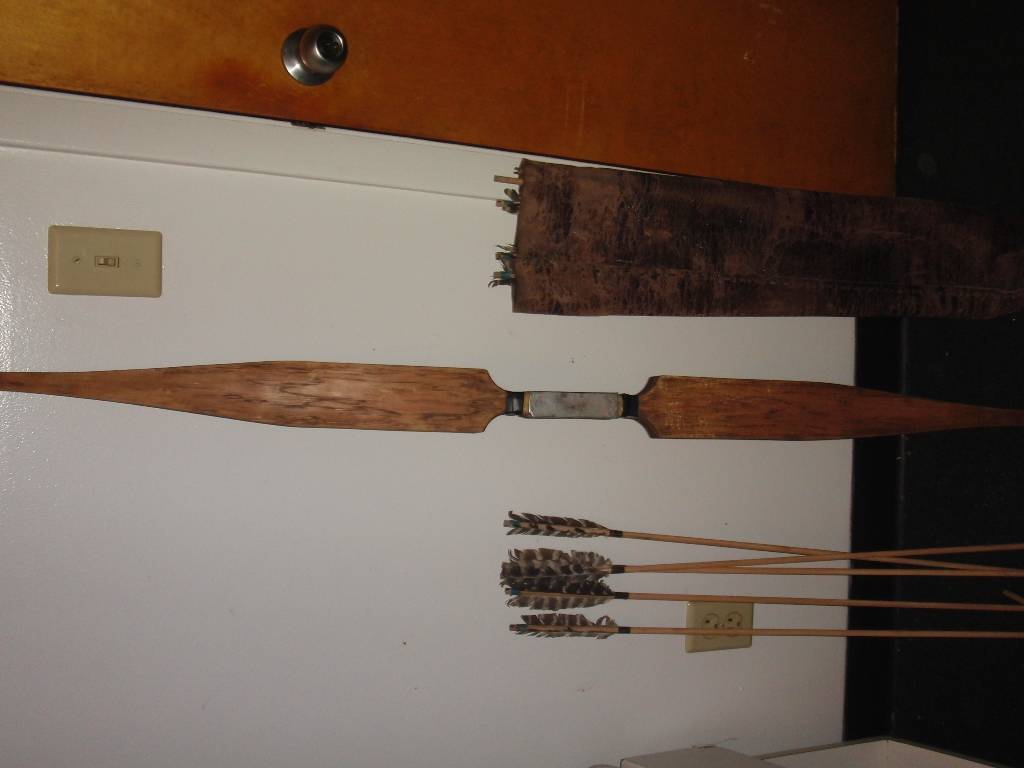

Finally got to get some pictures uploaded... late as usual.
50lbs at 26", though it can be drawn to 28".
2.5" wide at the base, plus it made of hickory so It's about as indestructable as an all-wood bow can get(Horrible growth ring violation on the back, and it holds up just fine).
I heat treated the belly and it improved cast noticably. Currently shoots about 155 fps max with a 30 gram arrow, which is about average for a slightly longer bow.
I have no idea where the string went. It was a nice kevlar string too. Oh well I can always make another.

Nice bow, what tools did you use to make it?
awesome bow, looks like a holmegaard design? I'm currently building a hickory bow made in the holmegaard style
- Fnord
- First Sergeant 2
- Posts: 2239
- Location: Pripyat
Thanks.
Tools used... let's see,
All the tillering was done with a small 1/2" planer and some really rough sand paper. I cut out the rough shape with a bandsaw(at work) and a homemade adz. A belt sander was used, mainly to shape the handle section. Adz wood make a good scrabble word.
To work the rings down perfectly flat on the back, I used, I kid you not, a 9" angle grinder with 40 and 80 grit pads. Traditional bowyers would probably burn me at the stake for that, but it's much quicker than working it down by hand. It's just really easy to screw up.
The design I used is just based on simple logic. Most of the bending and energy storage happens in the wide, heavy section. The tips are very light and thin, so not much energy is wasted accelerating them. The near-handle limbs don't move very fast compared to the tips.
The belly was heated over a hotplate; what this does is essentially "melt" the cell walls in the wood and allow them to contract, driving air out. This has the effect of making it more dense, and raising its compressive strength.
