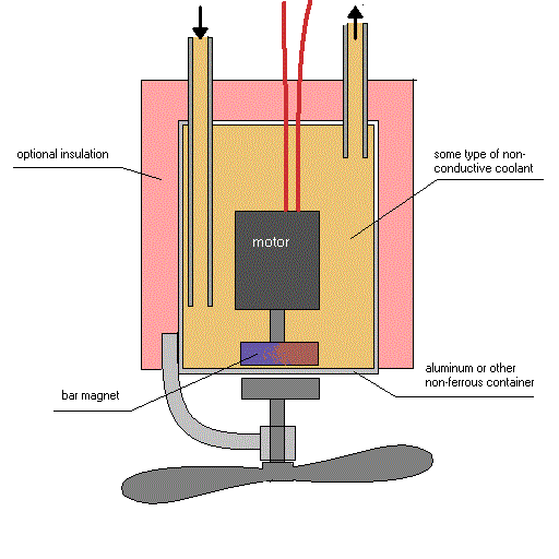

Giving this one final go since I don't think there is a solid solution yet.
This design isn't elegant but it should work. Not a pre-built solution by a long shot, but could be assembled fairly quickly from scrap if nothing else.
The whole unit stays in the oven.
The 'radiator' for this would just be a drum of hydraulic oil with a pump stuck in it.<br /><br />One possible issue is the fluid slowing the magnet rotation down... could be solved by making a disk shape out of it. <br /><br />The motor will need to be attached to the container wall obviously.
