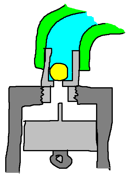

Mon Mar 26, 2012 11:46 pm
Your check valve could simply be an airsoft BB in the hose barb that has been appropriately drilled out, twentyfive bucks shmentyfive bucks ;)
cheap simple check valve.PNG (13.48 KiB) Viewed 6042 times
