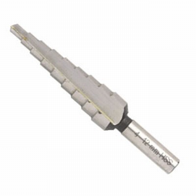

if the chuck can fit a 22mm bit it will drill, just take it slow and use cutting cutting fluid
edit: looked it up it has a 16mm chuck so you will need to get a steped drill bit(idk its right name) or spade bits(only alu)
this is a steped bit

That stepped drill is really intended for enlarging holes in sheet metal. You can buy larger diameter drills with a reduced shank size (13 or 16mm).
The second one down has a reduced shank Look for these.
The reduced shank ones are most common in sizes above 13 or 16mm. Most large diameter drills you purchase individually or in a set from a hardware store will have reduced shanks.
You can plausibly drill 22mm holes with a 375W drill, but don't expect it to be quick. Take it slow and use a lot of lube.
