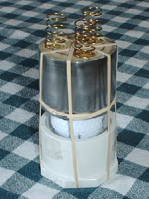

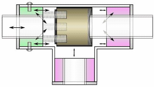

Well, after a year in the making. I've finally completed my piston valve.
I only have pictures of the piston to share, but I also have a diagram of the internals I made.
I don't have a barrel attached yet, but the kleenex test firing was promising.
The piston was made out of a hairspray can, silicone, a wood plug, a disk of foamie rubber, and three springs.
- The diagram (Revised)
- pistonopen2.gif (22.6 KiB) Viewed 4605 times

Surely the piston is longer than you drew it in the diagram? Otherwise when it's sealed at the barrel then air can escape from the base, or is that your "equilisation hole"?

beautiful piston and great animation looks nice as
i like the 3 spring idea is this any better than having just one? probably balance the backwards force better.

That´s one great drawing.
I think you should totally redesign it, because .. ha, no, just kidding. Looks good.
I did the same thing with leaving a gap behind the piston when fully closed. I have never had any pressure on that valve yet, though.
I think the 3 springs are because a single central spring would stick out of the pilot hole, haha. A larger diameter spring is hard to find.

The real thing is a little different than the diagram. The piston doesn't have a rear shock pad, and the cupped bottom has the foam disk. The barrel outlet is also not beveled.
BTW: I recommend InkScape to all those who wish to make great drawings like the one above.
The green area represents the non welded socket, three screws hold it on instead.
The only part that is airtight is the foam disk on the face of the piston, it is also pressurised from the tank, the pilot valve is the only thing on the back.
I've noticed a small gremlin in my design though, the diagram doesn't take into account the ridge in the threaded end cap. My father said he heard a slap when it was fired. The piston has only a small bit of clearance.
I'm going to have to trim that ridge down by about 3/4 of it's size.

Ridge trimmed, now waiting for glue to dry on repaired piston.
I discovered that it "sneezed" some silicone out of the can, so I'm sealing it with some "Welder" glue. The foam disk popped up and folded over in an area that wasn't glued, so that's being fixed also.
I'm using a baseball this time, it's pressing the whole disk down.

that diagram makes you piston valve look overly complicated, all the arrow that have no apearent purpose and the acuator pipe moving between slides

The pipe has been fixed and the arrows represent pressure.
