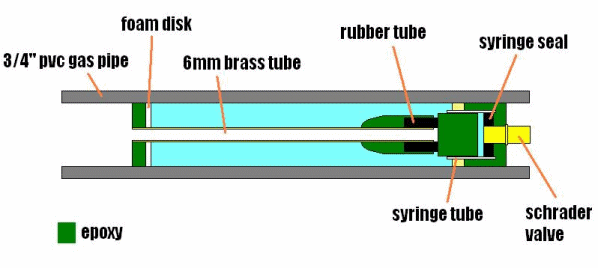

Thu Nov 15, 2007 11:06 pm
Another solution is to epoxy some rubber tube onto the barrel instead of the piston, as I do with my minis:
Mitchza89
Posts: 1056
Fri Nov 16, 2007 7:50 pm
Well looks like I found out why the tape plug isn't holding and the barrel keeps on sliding through it. I fill from behind the piston and I reckon that it seals too well. The air isn't equalising past it fast enough as I pump so it acts like a hydrolic ram and just pushes it out of place.
