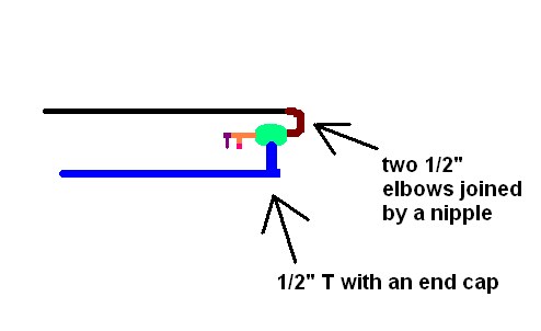

I tried several configurations of my qev gun... and I suppose i found one that is ergonomic and easy to aim and fire....
the only problem is that this setup has two 1/2" 90 degree elbows on the exhaust side before the barrel starts (of course there are two 1/2" nipples there too)...
I am a little worried that it may be reducing the gun performance significantly..... should I really worry about this ? anyidea how much does it reduce the power ?

It won't account for the actual pressure loss due to the bends, but GGDT can calculate the effect of the dead space. My guess is that it won't really matter much unless your chamber is really small. In some cases more dead space can actually increase performance.

currently my gun is configured like this... thep ilot side consist of 1/2" T with a BV and a quick-connect fitting

If you want to figure out space of a 90 degree elbow.. Its 1.5X the diameter of the pipe.
so a 2" elbo would be 3" of pipe a 45% bend would be 1.43--

Why not just turn the QEV around so that the pilot setup is to the right and the barrel comes straight out to the left, with no bends. (I am referring to your design where the barrel comes out the right side, but then turns 180* and goes to the left.) The problem would be solved by simply turning the QEV 180* more.
Thu Feb 07, 2008 10:40 pm
Without a chrony you probably won't see the difference.
