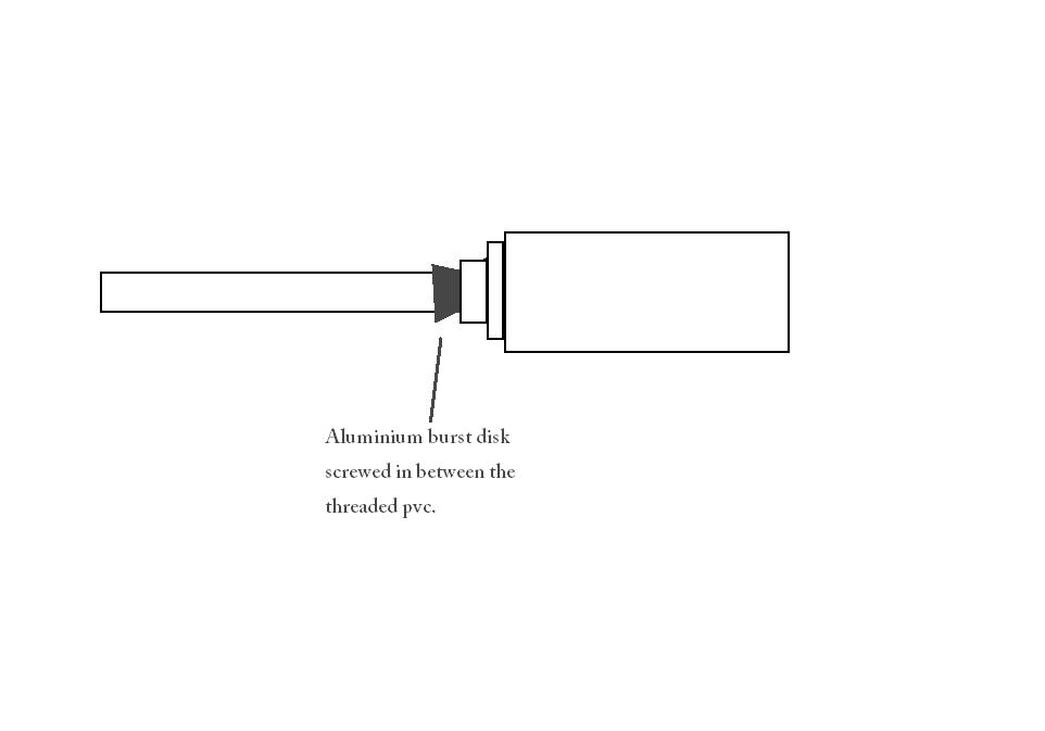

Woops I described it wrong.. There are no threads on it yet I am just using a connector and putting the disk between it. I was asking if the threading will rip the aluminium while screwing it on? Sorry for the bad description

No, it shouldn't tear the disk(unless you've got a pretty messed up union!!).

If you use a union to place the aluminum foil disk in and then tighte the union then no the treads shouldn't rip the disk any... (they shouldn't even be touching the treads.)
If you try and put the aluminum foil over the treads its not likely to screw on very well and even then your right the threads wouldn't do the aluminum any good.

What exactly is this union thing you speak of?
Is this what your saying is a "No No"

I'm thinking of a PVC union that looks like this...
http://www.sisale-international.com/pro ... 135013.htm
hope that helps
