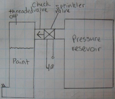

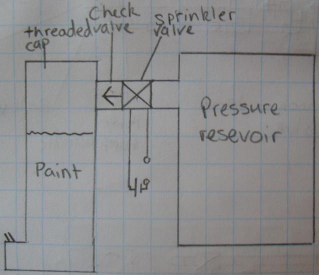

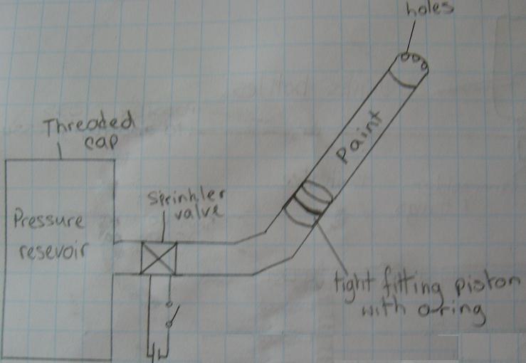

I had a think and drew some diagrams to make it a little clearer. Neither of these designs allow paint to go through the sprinkler, and both should be very efficient.

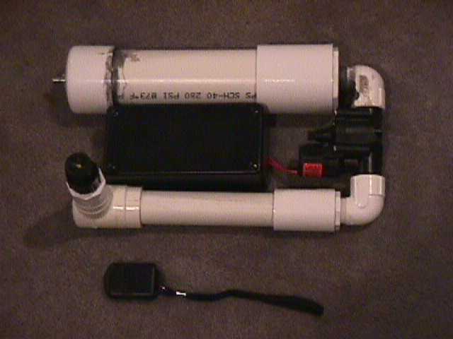

here are a couple that i have used before .
ImHUGEnJAPAN
Posts: 77
Joined: Thu Apr 03, 2008 12:08 pm
Sat Jun 14, 2008 5:13 pm
Grumpy
That's exactly what I want to make. How do they perform? Where did you get the remote device? In your design does the paint go back to the sprikler valve?

As long as you clean out the diaphragm, I don't think that's an issue.
By the way, your hand drawings are awesome.
grumpy
Posts: 331
Location: tampa,fla.
Thu Jun 19, 2008 9:49 am
sorry it took so long to post this but i had to go to hospital emergency room and just got out this mourning, the design is not mine but the plans are free for anybody to use. both mines work very well and i've never had problems with them,and no i have not had any trouble with paint getting into the valve. just wash it out at end of game. you can find the plans and all instructions here. http://www.geocities.com/pomanspaintbal ... tions.html

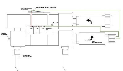

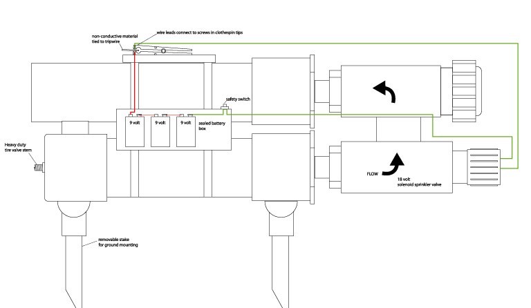

ajb12345
Posts: 36
Joined: Mon Jun 02, 2008 11:36 pm
Thu Jun 19, 2008 10:17 am
For a switch you can use a motion detector or you can look for my tripwire swith which is what I masking right now. :)
