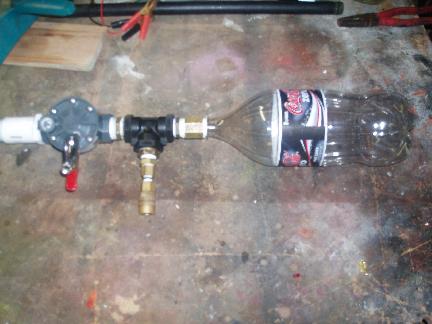

This is mylong barrel pneumatic called the M.H.I.S(makes holes in stuff).This is about my 4th made small bore pneumatic cannon because i live in a town and cant really shoot big cannons in here with out the neighbours complaining.

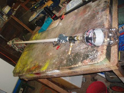

Well anyway i made this cannon today out of parts of other cannons except i had to buy the barrel,which is 1.5meters of 1inch class 12 pipe(equivalent to sch 40)i use a modded sprinkler valve which i had to offset the 1/4inch nipple as it is a guide rod modle valve.The chamber is made of a 1inch to 3/4 reducer and tee where i have a female air compressore fitting to air the chamber.The actual chamber consists of a 2letre coke bottle which i run at 90psi regularly.

The chamber modded valve and the filling point....doesnt look very mean at all..lol

This is my cannon as you can see it quite long and the barrel/chamber ratio is porbly terribly wrong.

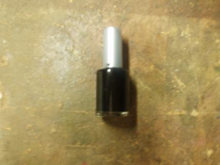

This is a small bottle of my sisters nail polish(i swear its hers,lol) it fits near perfect in my barrel,i plan to shoot tomoro with frozen water in it

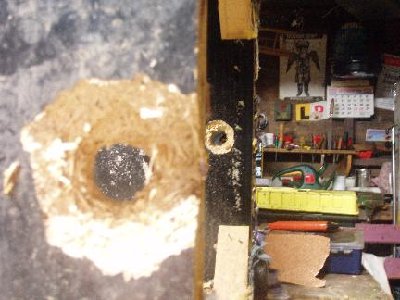

This is a pic of the damage my cannon can do to 3/4chipboard plank i was going to get a side view but my camera battery died i'll get some mroe damage pics up tomoro or some time

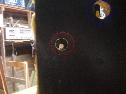

The red circle is where the sinker passed through,and you can see on straight through to the other side thorugh the other hole.and the blue was from a schampagne cork.

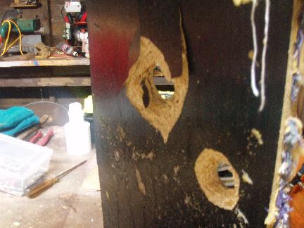

This is the oposite side of the first sheet,the clean hole is fromt the sinker and the other was from a schampagne cork,no joke a cork!at 3 metres and with only 10mm screw at weighting.

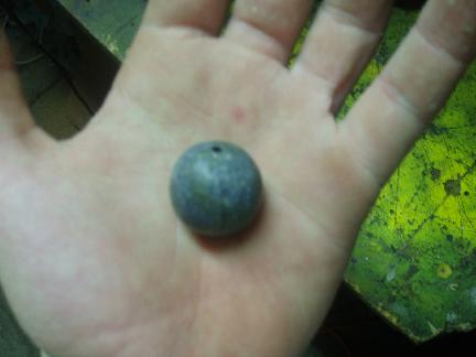

The sinker that i shot through the 2 sheets of chipboard.

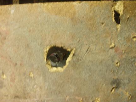

This is a box made of 3/4 chipboard and i shot a sinker with wadding right through both sided then it flew and bounced off my fence and landed on the roof of my house.

what size are the theads to connect onto the coke bottle?how did you connect the coke bottle to the back of the gun?

Well i am actualy planning to use a 50mm chamber out of class 18 pipe
(sch80 equivelent),now how i connected the coke bottle..this is a little crazy and stupid,but its only ever failed on me once and that was when i was using ball valves,but still i ran 90-100psi.first off all it is a 3/4 female nipple which i screw the bottle into its standard threads,but i use a rasp and file back the thread ont the bottle of the coke bottle till its a near fit but still tight,then i cover it in about 20layers of sealing tape and jus screw it into the threads it start off easy but if u did it right the thread bites into the bottle and then i get some vice grips and screw the bottle in as far as it can go.and then test for leaks,and unscrew and add more tape if needed and when its unscrewed you can see the thread made by the brass fittings.
