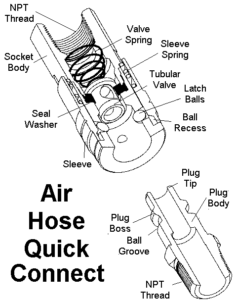

I had a quick try putting some pressure, but unlike what I thought the pressure leak around the central spring plug, not from inside (it is a tube on my quick connect, so I guessed it wrong).
So a sort of seal with a O-Ring or a washer is mandatory, and maybe a complete replacement of the internal mechanism, just keeping the ball locking. After all that's the most complicated part to build.
My first guess would be to drill through, and make something close to the left side of my previous drawings. A cooper tubing epoxied there (Yeah!) and a O-ring that touch the ball.
Maybe some other model of Quick-Connect would be more appropriate, as I have another one that doesn't look exactly the same inside.

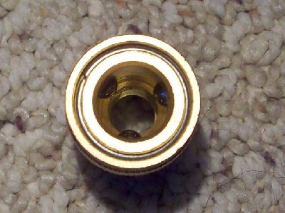

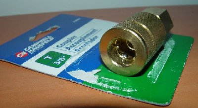

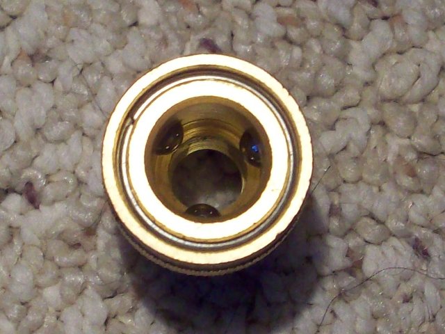

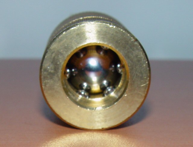

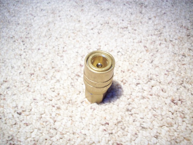

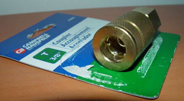

For those interest by the idea of using a quick coupling, I am most pleased to announce that a 3/8" coupling is a perfect fit for the .56 ammo I want to use...
So laziness will certainly win, and at some point in time I'll try to convert a coupling to a trigger instead of making one from scratch :-D
with a 9/16" = 0.56 ball bearing inside
brand new 3/8" quick connect

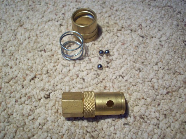

Edit: A disassembled male connector

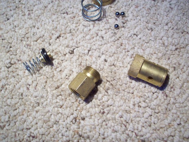

Edit: Some food for thoughts...<br />The connector simply unscrew in 2 parts....

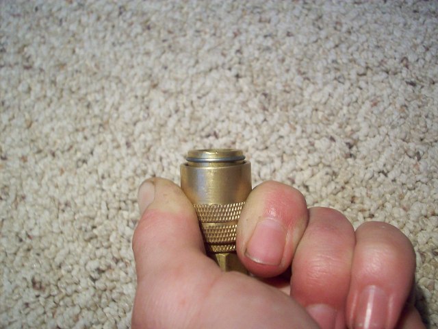

Posts: 3640
Been thanked: 62 times
Sat Jun 06, 2009 7:19 pm

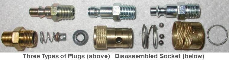

Useless post, but just in case you're wondering how to take one apart...
Assembly is reverse of disassembly.
Now, you can remove the check assembly.

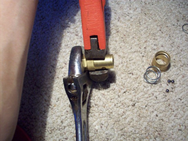

Grip the main body as pictured to separate it. They are pretty tight...
After this, you will be left with the components below.
There is a snap retaining ring which prevents the sleeve from being removed. Relieve the coupling of it with a flathead screwdriver.

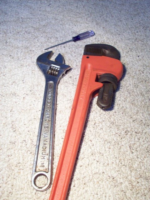

Tools you may need.
Tools you may need.
A 1/4&amp;quot; auto coupling.
A 1/4&quot; auto coupling.

Thanks mark.f
I guessed roughly that, but it is always nice to see a how-to !
Posts: 3640
Sat Jun 06, 2009 7:54 pm
Yeah, I had one lying around, and I was curious myself.
