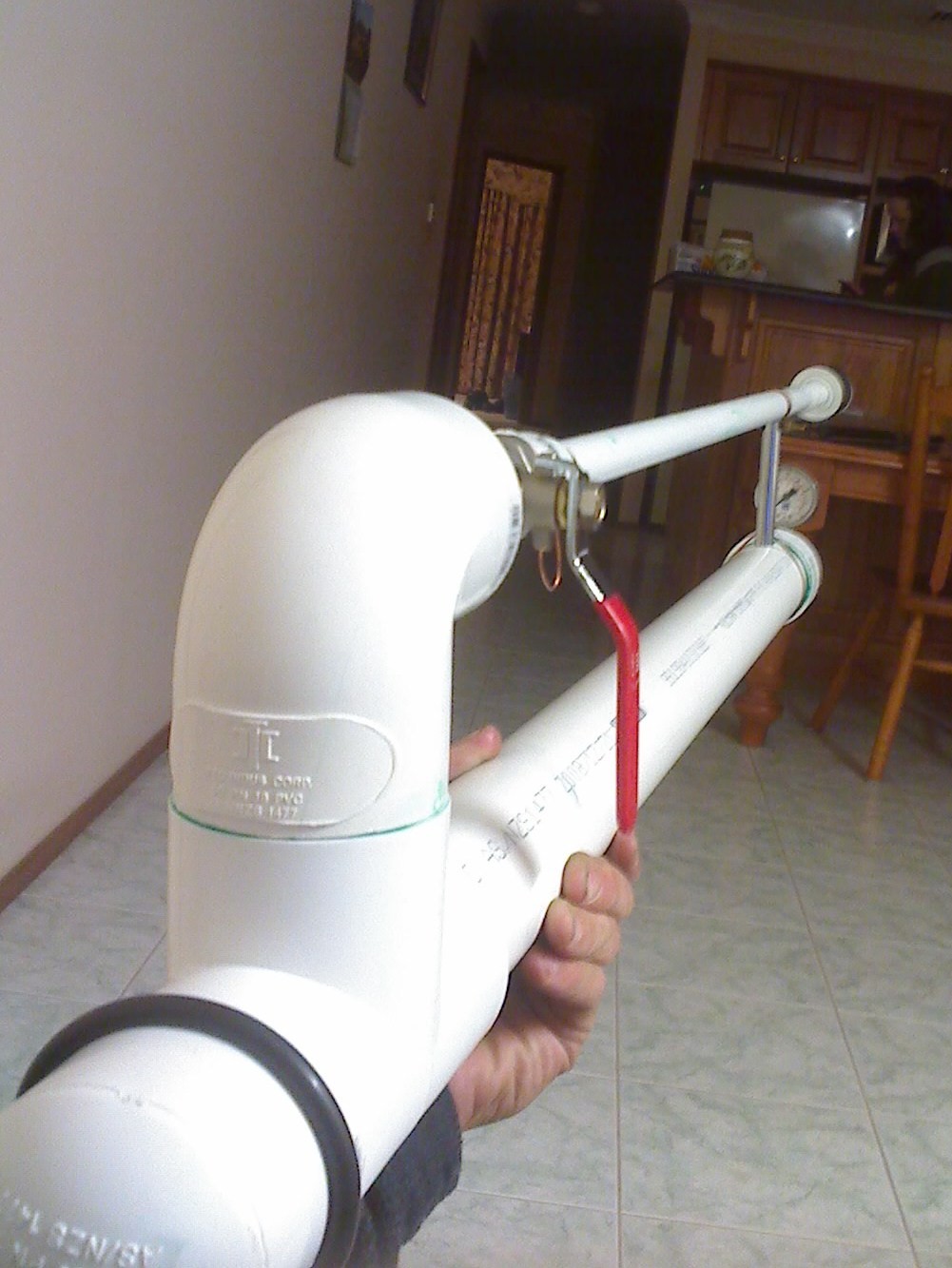

well here she is my first pnumatic cannon

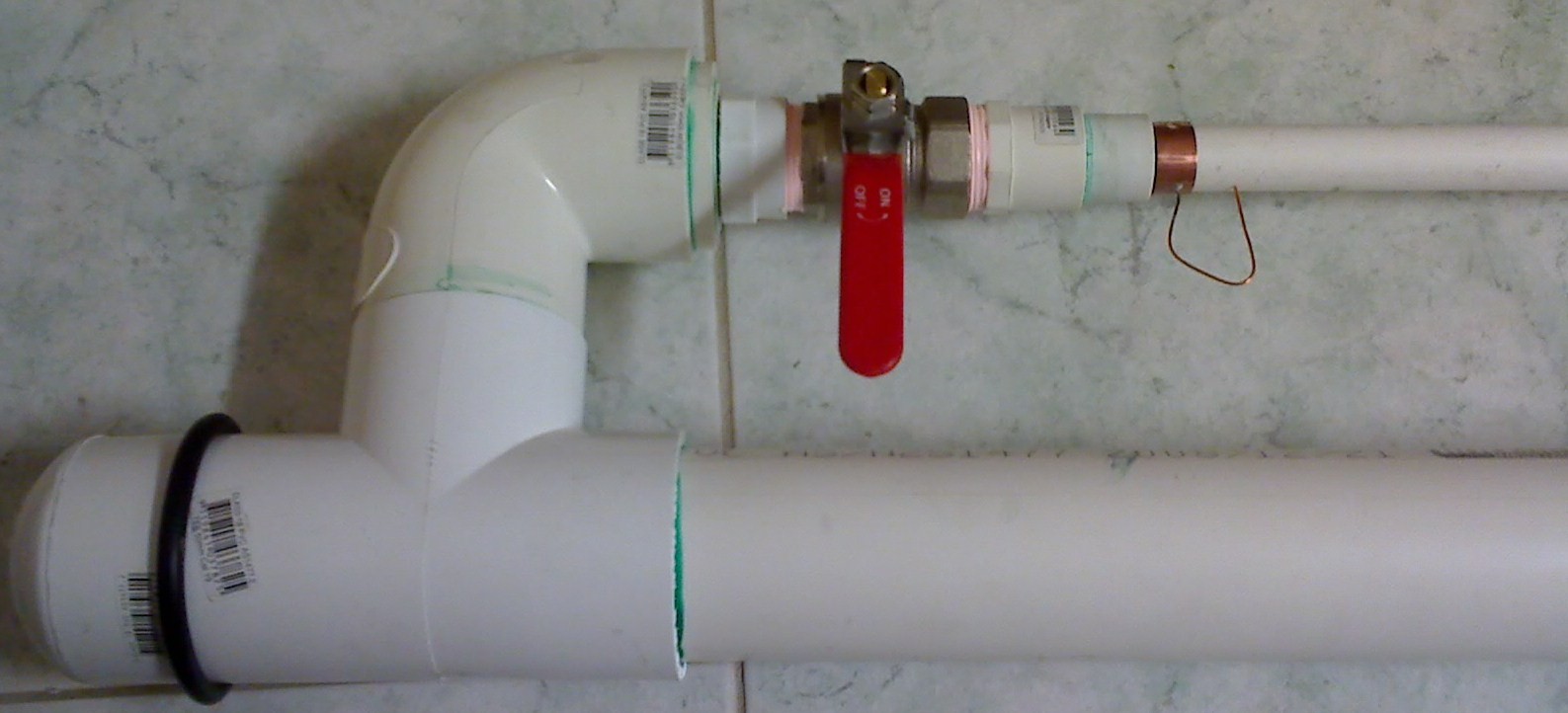

im using basic pvc pressure pipe with a very loose ball vavle,i didnt have the time to look for a modded valve but all in all she works good...
ive fired it at a bunch of towles i had hanging on the cloths line at 80 psi, with a marble.. it went straignt threw five layers of towleing!!! i cant believe it........ the barrel is the perfect size for a marble ,,im now throwing my combustion cannon to the shitter and embarking on my pneumatic cannon journey.. :idea: :idea: :idea: :idea:

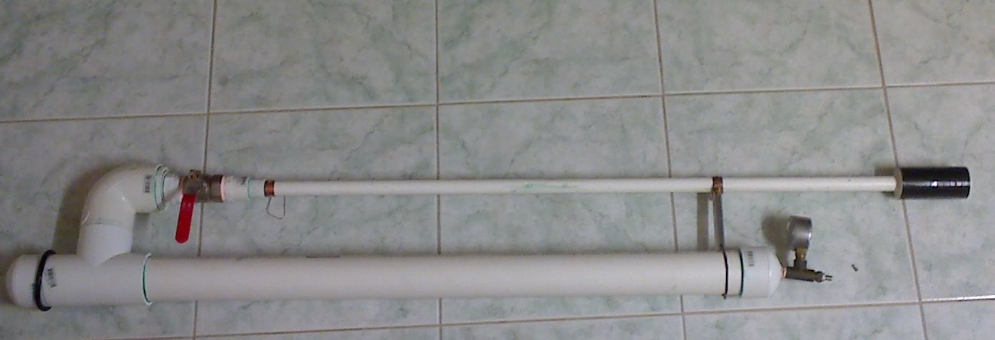

there she is (1250 mm long)

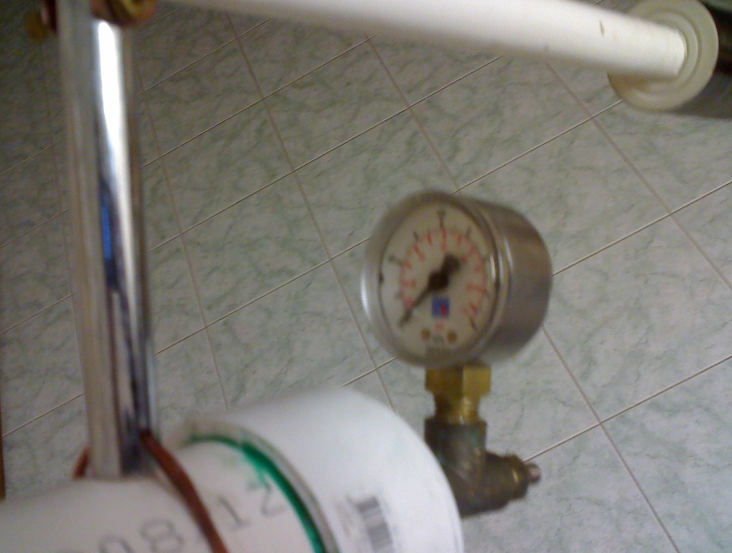

gauge setup ,shrader valve and brace to support the barrel
about 4 hours work on and off

cant say im a fan of mini weapons,but anyway as for modding a ball valve i dont think there is much u can do other than trying to wear out the seal so its not as tight and applying some grease/lube, and maybe a longer handle because leverage is ur friend...

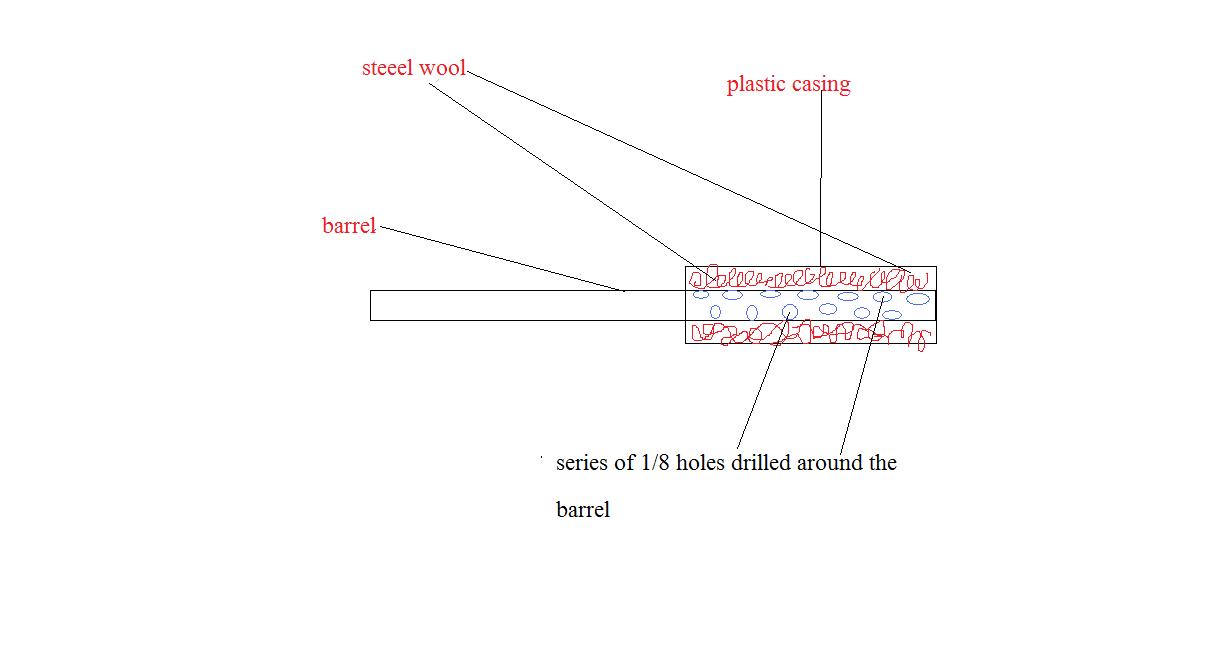

well ive had this idea of modifying my pretend suppressor (atm) just wanted a few thought on the below diagram..
will it benifit at all or its not worth it?????

Nope, your chamber is too massive for any reasonably sized suppressor to have a difference. If you hacked up a rubbish bin into a suppressor it might partly silence it.
Quite a nice gun..how about a piston?

im glad u answerd that before i started drilling holes in my barrel,which brings me to my next question,,and like u must off read my mind,because i was about to ask the question on what a piston cannon is??? and how does it work??? diagrams would be good....

Nice little marble shooter. I agree with another post the chamber is way too big and past the point of diminishing returns. If you get a chance, pick up a copy of GGDT and calculate the volume of the chamber and barrel. You will find that most likely with the combination of that barrel and chamber, over 85% of the air is still in the chamber when the marble is out of the barrel. A barrel 1/3 the size or even smaller will provide close to the same performance and use only 1/3 the air or less per shot.
Since you barrel does unscrew, you may wish to try some other barrel sizes for larger projectiles. :D

looks great, ive worked with pneumatics myself before. May I suggest you use a modded sprinkler valve in the future, pneumatic or electric firing, much quicker opening time.

thanx i really wanted a 1" sprinkler valve but cant seem to find any website that alows me to use paypal and send to australia and thats cheap..any ideas??? so i went with the ball valve for now,, ive just finished spraying my chamber jet black it looks good,and i ordered a scope from ebay http://cgi.ebay.com.au/ws/eBayISAPI.dll ... 0412397339
