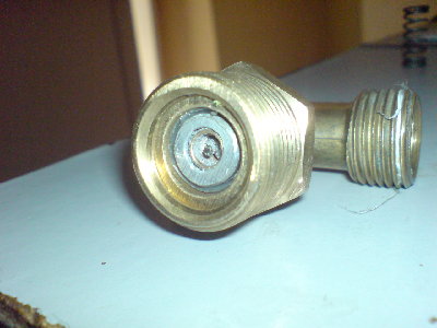

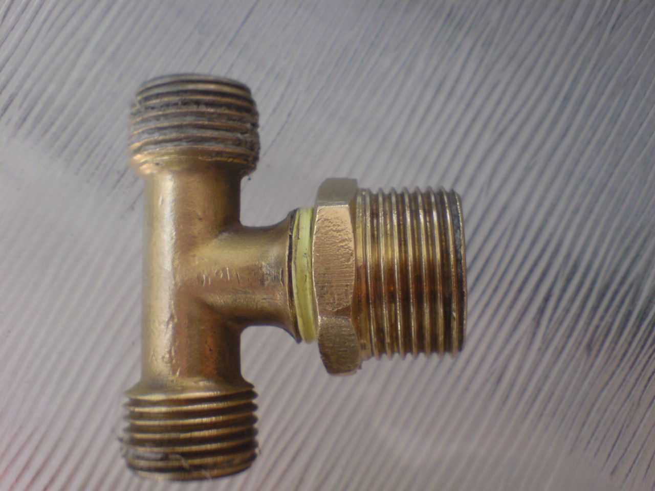

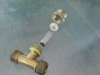

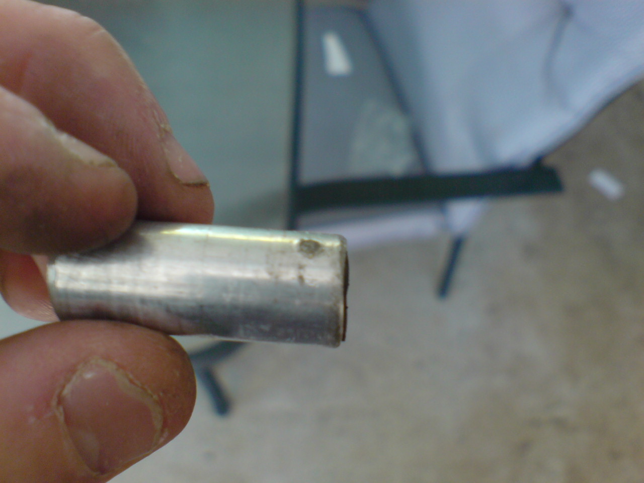

It's been a while since I've built something so I thought I'd make a new pump that should take me past the 500psi mark. I wanted to create a simple check valve that I knew would work. I used to have blowouts at about 300ish psi with my old pump due to the check valve I made with washers, o rings and bolts.
As all of the old spudders know, I use compression fittings for just about everything so I thought I'd put that to use in the new check valve. I got a schrader valve and sleeved it in 12mm aluminum tubing. I just trimmed the rubber off the back and squeezed it in so it was an air tight fit. I drilled a nail through the back of the aluminum tubing and through the brass tubing inside the valve to prevent a blow out.
It was by far the quickest build I've done for a check valve. Because of it's simplicity I shouldn't have any problems (Don't jinx myself! :D)

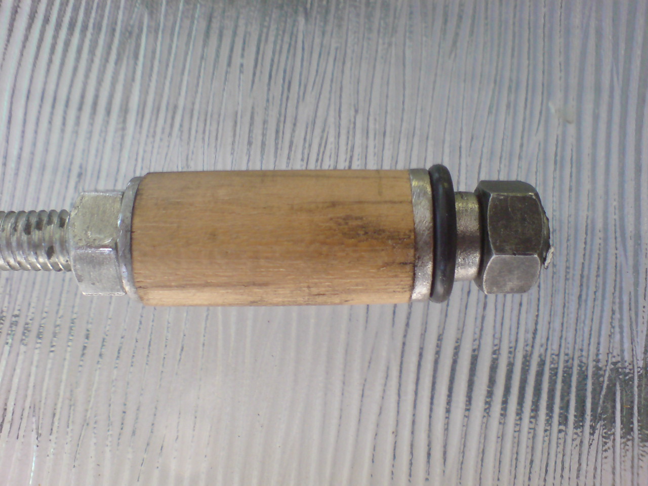

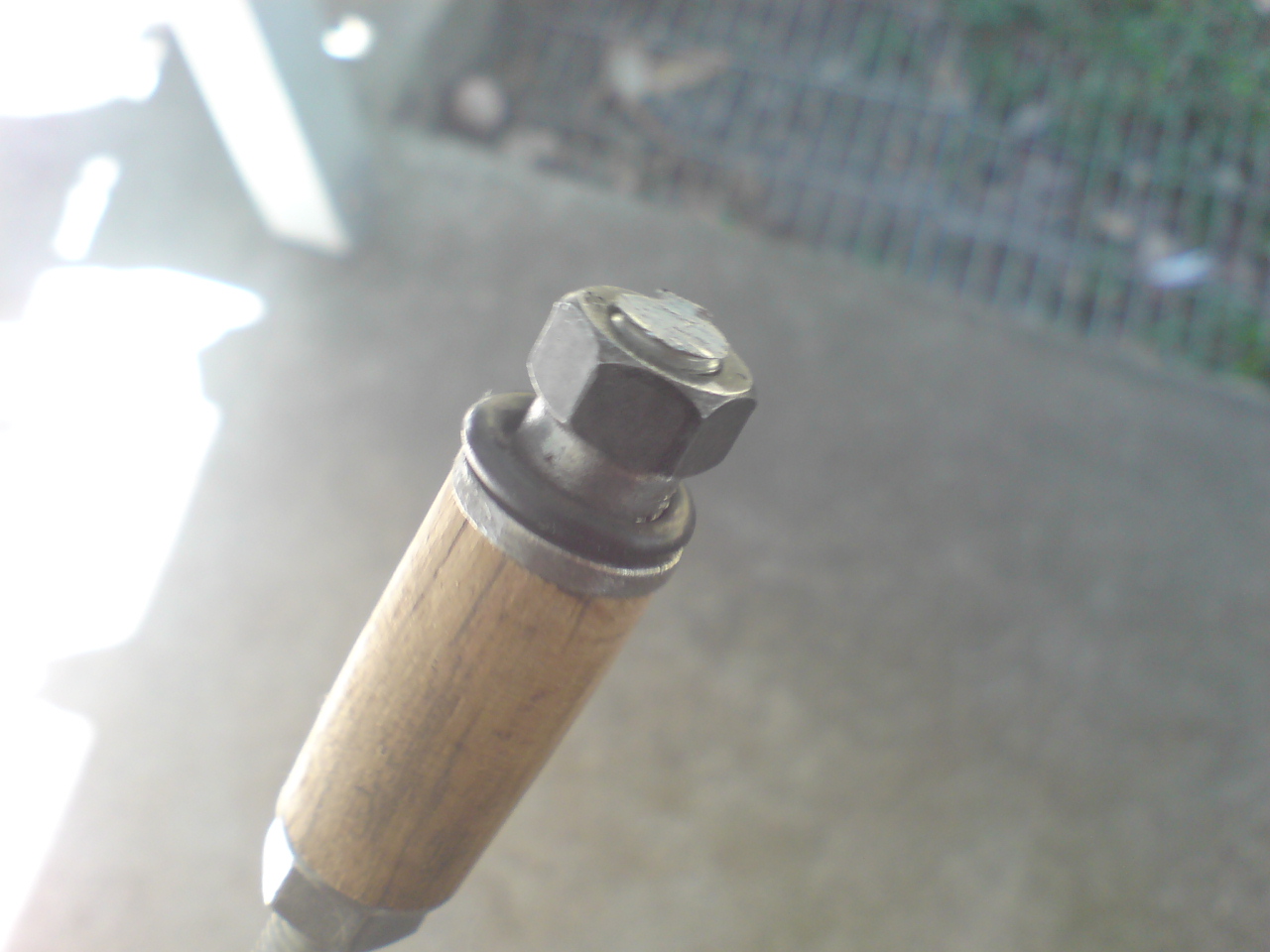

Nothing much can be said about the pump head. I wanted to do the piston head out of aluminum rod but I had none around so hard wood did the trick :D
Thanks guys!

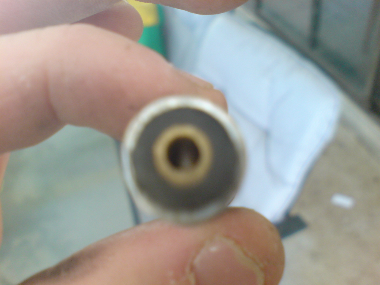

The nail grinded to fit flush.
Crappy quality but you can just see the nail through the back of it.
Pretty self explanatory.

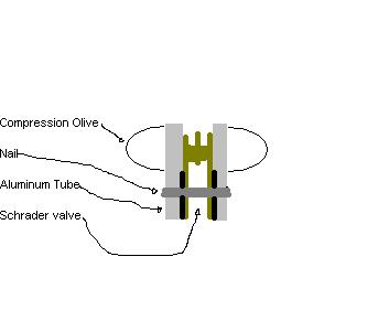

I've added a diagram of the valve to the top of the page above the other pictures. Hope it helps!
Spudtyrant, The compression fitting keeps the aluminum tubing (outside of the valve) firmly in place but I was worried about the schrader valve blowing through the the tube. The nail is to prevent that from happening.

Btw your piston is a stunner mate congrats

Maybe you guys remember the front teeth-broken upper jaw incident I had with a similar pump...
Still carry the mark of the nut in my cheek..\
That checkvalve used similar material to the olive to keep the checkvalve in position...It blew..
In my opinion the aluminium section could be blow right trough the fitting if the olive looses it's grip.
Well...I know compression fittings can hold quite a lot of pressure...just...make sure the entire aluminium section has NO way of blowing out.
I love the retro wooden piston!!
