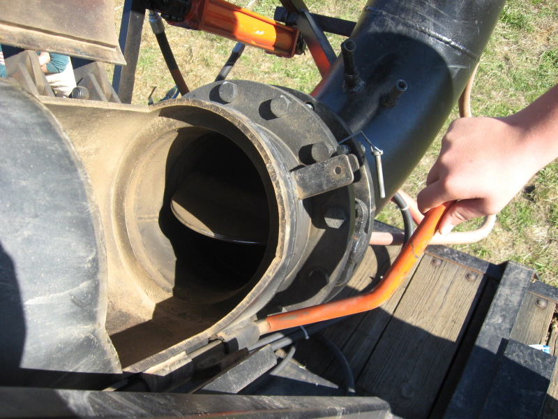

My ASME team might consider registering as a side project. It seems the contest is essentially longest barrel and highest pressure (to an extent) wins. It's all an issue of money, time, and space to build. Is there any evidence of a pumpkin gun using anything else than a butterfly/ball valve? It would seem like it would have the leading edge to victory.

Butterfly and ball valves are acceptable in punkin chunkin due to the massive barrel. The huge flow you get, along with them being easy to get (and rated) makes them ideal, especially when actuated by a ram or similar.
Though there would be no issue with maximum power, burst disk or perhaps a QDV..
You could use multiple smaller pressure tanks, welded to a barrel section with the disc or QDV... Or if you can get an LPG tank from a service station..make a co-ax :twisted:
I'm sure you can figure something evil..I'm looking at the potential of a QDV with 1000+ Psi at the moment..
