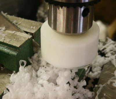

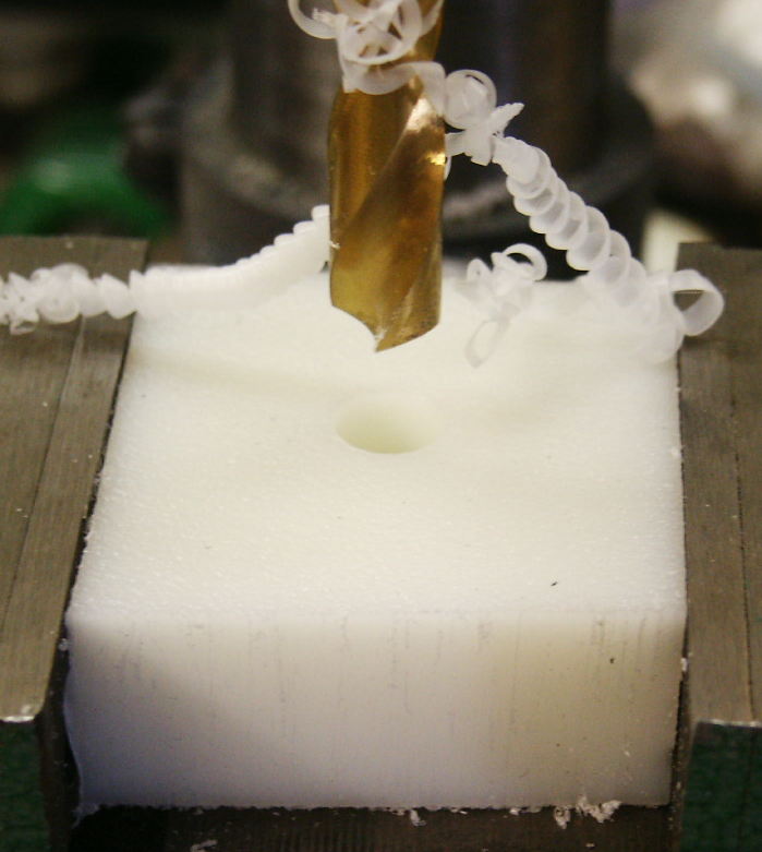

I cut squares from the plastic and drilled a hole into, but not through it.
Then I screwed in a bolt with the head cut off and put it in the drill press chuck.
I used a wood chisel clamped in a vise as the tool to cut it round by lowering the chuck past the tool.
After it is round, a ground down chisel was used to cut into the sides to make the 2 grooves. Sorry I don't have a photo of cutting the grooves.
Tools used include;
A skill saw with fence to cut strips and then cut squares
A drill press
A Drill Press Vise
A set of wood chisels
A grinder to make a chisel very narrow
Digital Calipers to check everything for size.

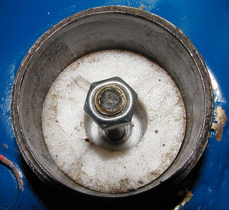

It gets stuff in the grease. Everything from tennis ball fuzz to paper towel fuzz collects in the grease. I added a photo of the gauge so you can see the pressure drop. Holding pressure for 5 minutes is not bad for a home made valve.

Wow the pressure drop was only about 5 psi, that's pretty good for a dirty piston on low pressure. To remove it, do you take off the back cap and pull out the internals or remove the handle and push it out the front?
Fri Jun 11, 2010 7:51 pm
The nut unscrews off the front of the rod and the piston pulls out the front.
Remove the nut and pull out the piston to service the valve.
Gun Freak
Lieutenant 5
Lieutenant 5
Posts: 4971
Fri Jun 11, 2010 8:00 pm
Ah, thanks for adding the picture! I presume that nut also serves as the "pin" that pulls the piston back too? And there is another sort of "pin" behind the piston that pushes the piston back forward to seal?
Fri Jun 11, 2010 8:59 pm
You are correct. The nut pulls the piston open. There is a welding rod pin behind the piston. Since little force is required to close the valve, it uses the same 1/16th inch rod as the Marshmallow cannon. It is pushed through the hole and the ends are folded over so it can't fall out.
This makes the pin small enough to retract back out of the way when the piston is fired. The piston can't come back far enough to hit the pin when fired.
