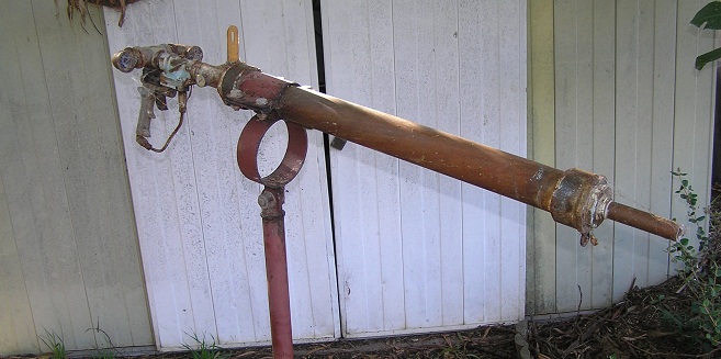

Heres a harpoon gun that was made quite some time ago, in fact it would have been posted on the old old spudtech forum 9 years ago. Back then coaxial piston valve guns were in their infancy and anything other then PVC was unheard of. I made this in my dorm room at university, power tools and all :) a visit from security was shrugged off by saying it was a prop for a movie.
No it wasn't made for any practical reason, was only converted to this as the brass gave it a nautical look. It did work, however the broadhead tended to act like an anchor making reeling it in problematic. Edited for content.
Its a 1" bore barrel coaxial with a 2.5" brass chamber. Coaxial piston piloted by a modified brass solenoid valve piloted by blow gun trigger.
The sight was a crosshair made from solder wire, this was done so to aim it in you would just bend it a bit until it lined up a quick easy adjustment.

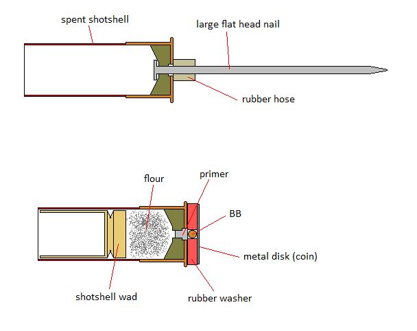

Its staple diet was not the harpoon (got sick of bending that back straight), spent shotshells are a nice fit in 1" barrel so sliding them down backwards gives a nice fast straight shooting projectile. They could be modified as in the attached pic, I was driving the nails into a concrete wall and the other would pop into a cloud of whatever your loading was. Nice abundant ammo is your a keen shotgunner though you can buy bag fulls for the purposes of reloading if you wanted.
Sadly the gun come to rest in the junk pile and is in a sorry state now, see pic. I'll have to give it a polish up I think.

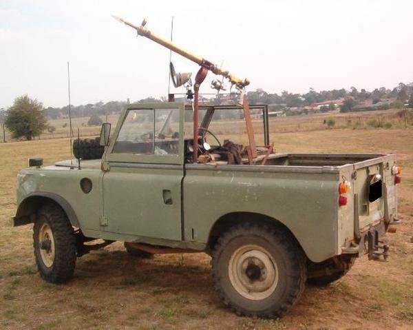

Mounted on landrover.

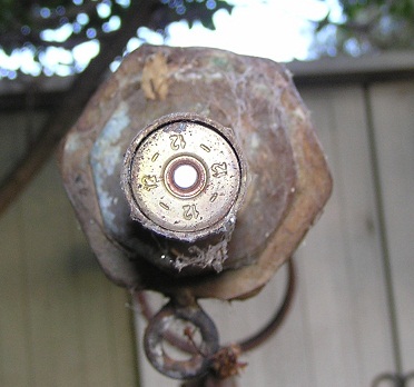

The barrel is 1" copper, see the pic for the shotshells fit in it.
They flew nice and straight and act like wad cutters, Although I'd typically use "raw" reloading shells that have never seen a crimp.
They are a sliding fit, if you dont want that a bit of tape round the brass section helps. I would think slicing into it can only hurt accuracy.
