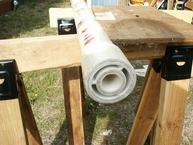

To make the OD of the piston smaller in diameter, the piston was fitted inside a smaller piece of pipe. To reduce parts count and make it unique an unusual construction trick was done. I placed a 1.5 inch female adapter inside the 2 inch chamber by heating the chamber and shoving it in stretching the chamber larger to fit. The female adapter has a very short piece of 1.5 inch pipe inside it to become the piston cylinder.

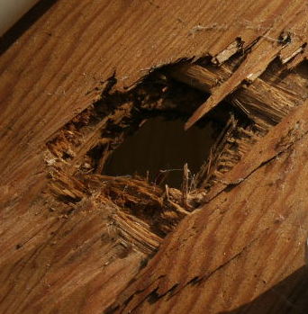

In testing to see if it met the design goals, a fast valve would be needed with good flow to get high speeds on light projectiles in the short barrel. I didn't have a chronograph. I decided to splat a gumball on a sheet of plywood to see if it would dent it. To my amazement, it punched a hole right through it.

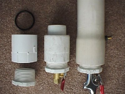

Piston showing the small eq port and the crack that failed the last pipe cap valve. Most piston failures were a hole broken in the very center of the face of the piston. This is a spot not hit by anything. It is PVC fatigue that caused the failures. The hole was drilled with a printed circuit drill bit. It is tiny.

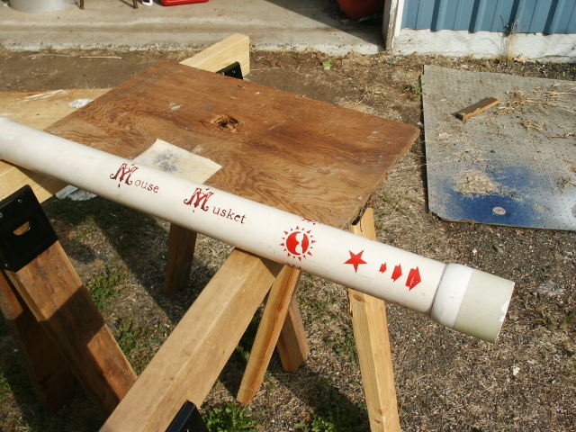

A decent shot of the Musket artwork finishes this series of photos.  This cannon lasted 5 years.  It broke almost a piston per year. The sandpaper glued to the board is the piston size adjustment tool. ;-)
This is the exit side of the hole.
Gumball hole.jpg (37.4 KiB) Viewed 6202 times

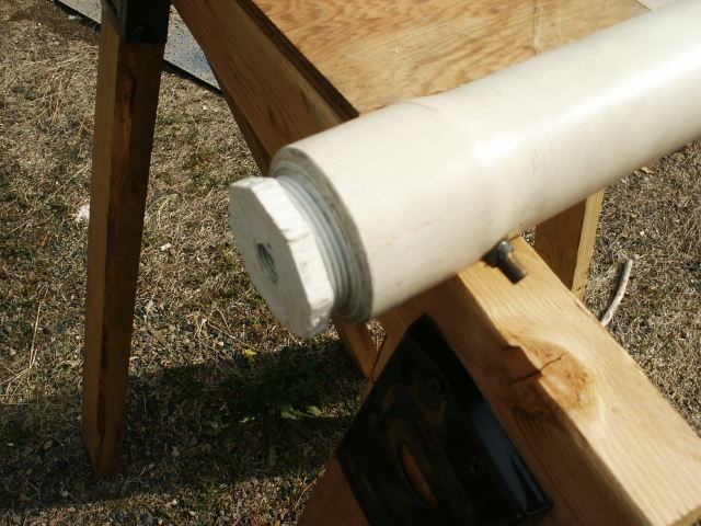

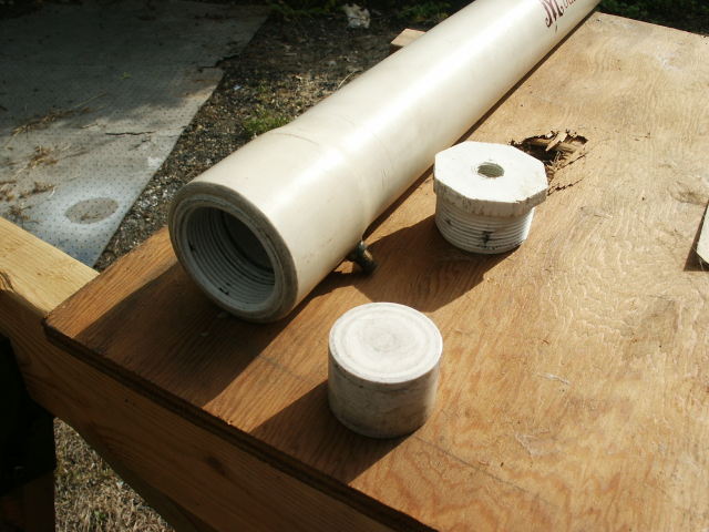

A 1.5 inch pipe plug with a hole for either a blowgun or 1/4 inch ball valve finished the cannon.  Note the hole in the plywood.  This is a gumball hole.  The o ring seal area on the piston face can be seen.

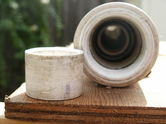

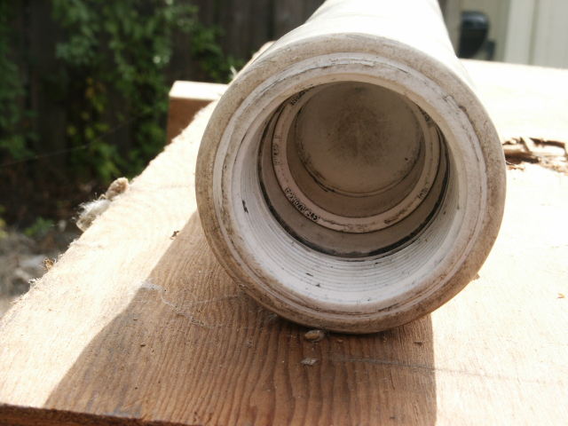

With the piston out you can see the valve seat.<br />The piston was gently sanded on a piece of sandpaper glued to the plywood until it just fit inside the breech.  Note the sanded appearance.
This shows the original PVC 1 inch pipe cap as a piston inside the 1.5 inch inner cylinder in the female adapter.
The Musket Breech showing the 1.5 inch female adapter inside the 2 inch chamber
The muzzle showing the unusual use of a reducer

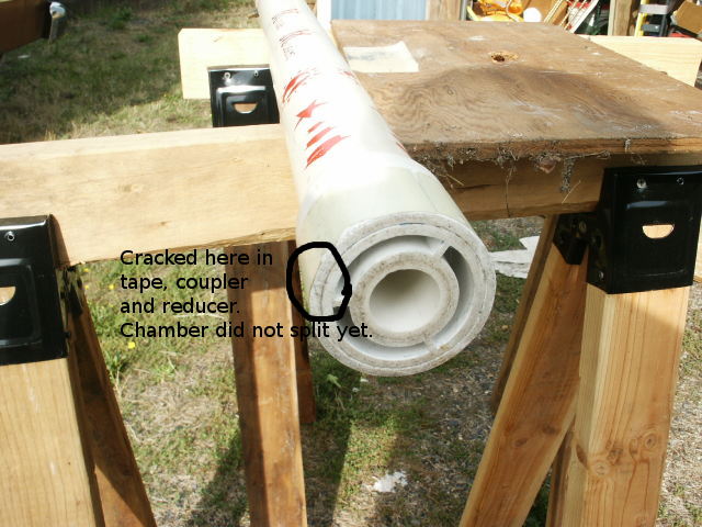

All good things must come to an end.  This got knocked over and cracked the coupler.  The crack spread inside to the chamber wall and reducer inside.  The reducer crack leaked.  The leak was discovered before it blew up.

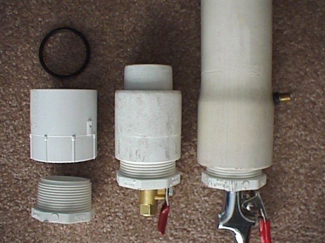

Musket breech detail.  Female adapter with 1.5 inch pipe is added in the 2 inch chamber.  The o ring becomes part of the valve seat.
