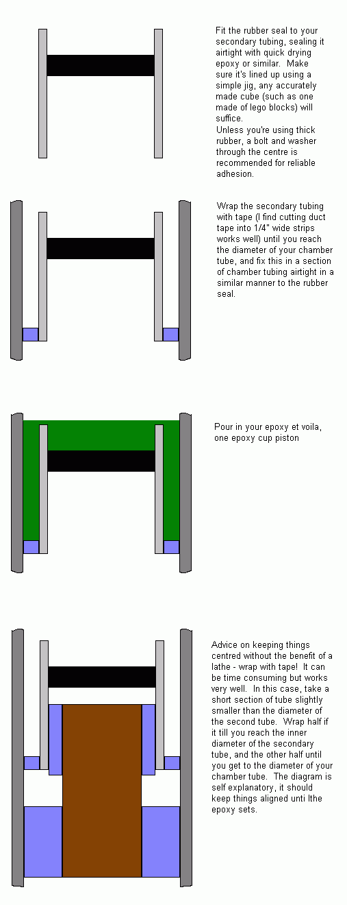

Depending on what kind of epoxy you're using, there is the option to cast the entire piston out of it. Since it's large diameter though, a solid piston would be a bulky and expensive affair, however without some thought you could cast a light and efficient cup style piston like the example below:

You sir, are a godsend. Me and my brother have been trying to find an easy source of airtight rubber sheeting, and mouse pads never crossed my mind.
couple questions though...
1. whats the purpose of the bolt/washer in this design? is it hard to keep the neoprene in place while the epoxy sets? does it just provide extra support for the rubber?
2. I read your post on how to cast a solid piston, but I don't see a description of how to do it with a hollow one like you are recommending. Cast what is basically a small solid piston inside the 90% tube, and then cast a larger one between that and the full size tube? do you have a recommendation for keeping the 90% tube centered during casting? It looks like the 90% tube is in 2 different pieces, is that necessary, and if so how do i keep all of that lined up properly?

As to piston casting, this should answer all of your questions:

the bolt and the washer stop the sealing surface from being blown out the chamber, because the force going around it and out the barrel will usually rip it off after a few shots

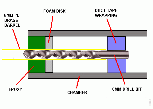

Further to the above advice, this is a typical setup I use to align the barrel when making an airsoft coaxial. It is important of course that the foam disk is cut accurately, if you are not sure how to do this you can wrap that section in thin strips of tape instead of the disk.

Do you need epoxy to do this? and what is the foam disk for?
It's all in the how-to, have a look
