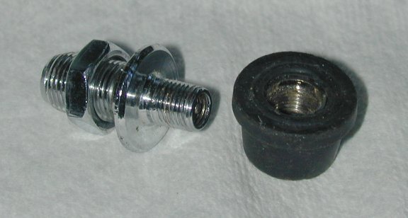

Or, you could go to your local tire store and ask for one of these.
valve stem.jpg (27.3 KiB) Viewed 1678 times

Those are hard to install in a finished air chamber. This is for the fix, not a new one.

If it's possible to remove the schrader valve, you could cut through the chamber, then install the stem that Oxbreath posted, and then use a coupling to put the chamber back together.
Might not be the most elegant method (I would go with Tech's) but it might be easier.

Fri Nov 19, 2010 8:17 pm
I got one here.
