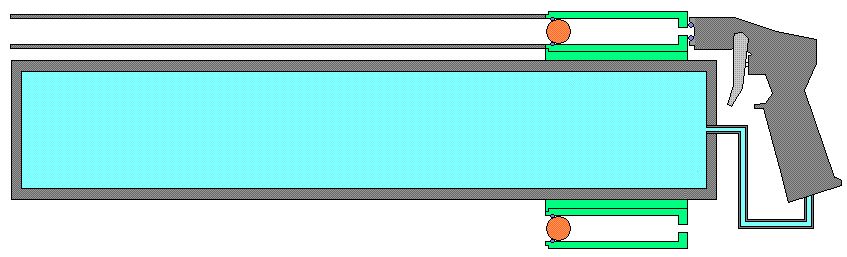

Thu Nov 25, 2010 1:32 am
Here's a conceptual drawing of how one could achieve multiple shots from a single chamber with a spring loaded piston valve:
Note that the piston is not completely airtight, meaning air is free to flow back into the pilot chamber after each shot.
You could combine this system with a revolving magazine for reloading, maybe coaxial with the chamber.
Another option would be to have "valveless" cartridges conceptually along these lines (or using burst disks if your projectiles aren't suitable for a friction breech) but with the "cartridges" fixed in a revolver type mechanism, something like this:

There is NO disadvantage to having "multiple" chambers, like on my trident. It's actually modeled as one 28" long .495" inner diameter chamber.
If you were to use multiple cylinders like on the grenade launcher, you'd have each pre-pressurized and sealed. As you fire one, the next one slides into position and you use some method to unseal it, maybe a check valve where you simply push in on the sealing face of the check valve to force it open. Rather like JSR's second diagram, except with the barrel in the middle and the chambers on the outside. I wouldn't advise trying to build pneumatic cartridge system (here JSR and I are talking about the same thing) before you've built a piston valve though...
2-D Design software? I actually just use autoshapes in PowerPoint, I know some people use paint. There's really no need for high-tech 2-D design, just use what you have available.
