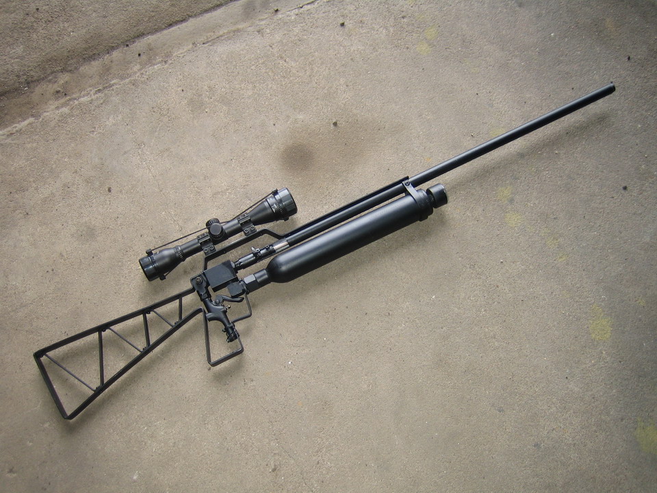

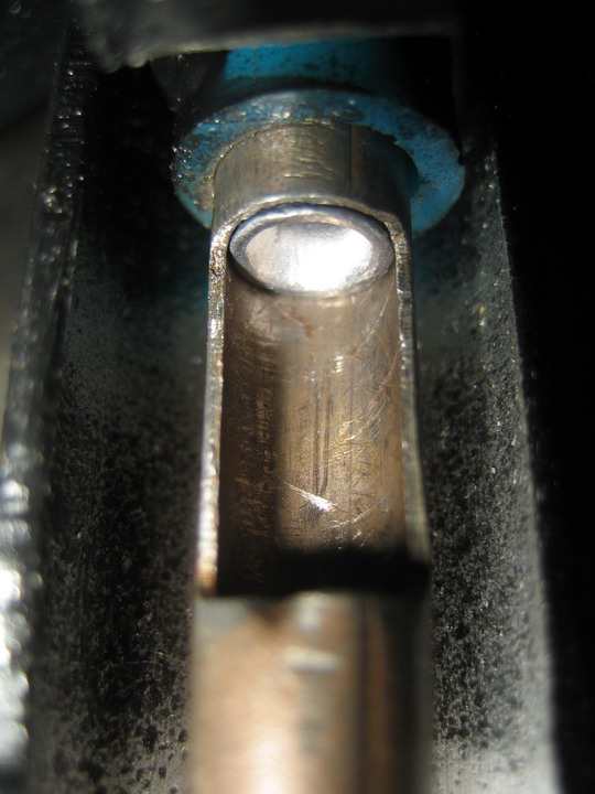

Hi all,
As a carry on from our previous attempt http://www.spudfiles.com/forums/first-r ... 22714.html we decided to build another rifle, hopefully improved.
The priorities of this gun were accuracy over distance first, then power.
It may help a few other aussie readers to know that this is Australian made (from Chinese parts of course).
The new rifle has the following specs/parts:
Compressor filled

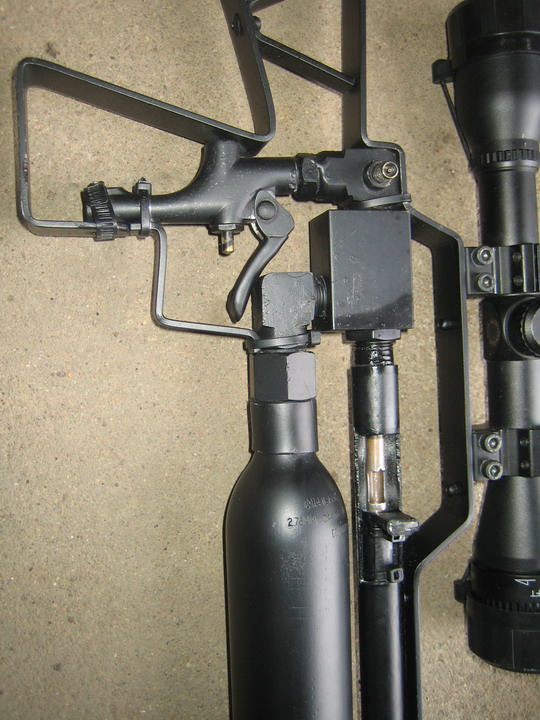

(empty) Soda stream bottle as chamber
QEV valve from ebay http://www.ebay.com.au/itm/G3-8-Pipe-Pn ... 459wt_1139
Blowgun as trigger
Brass fittings as needed
steel barrel (aluminium barrel shroud)
Aluminium stock/frame
Small piece of compressor hose for breech

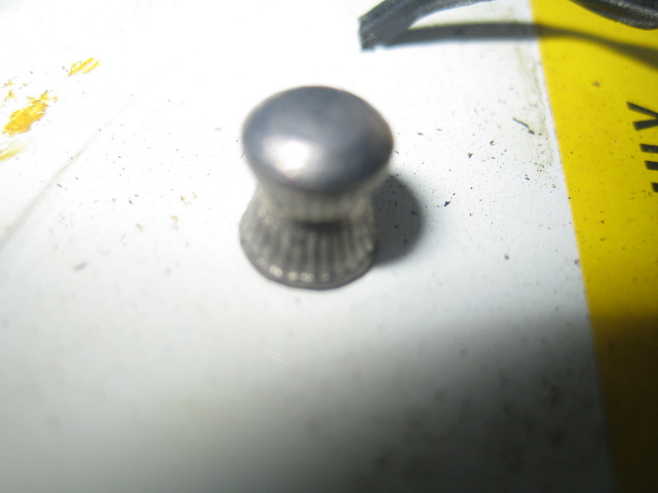

Fires .25 Air rifle pellets
I should have taken some photos before I lazily sprayed the whole thing black.
A few thoughts:
We kind of made this thing up as we went, sort of finished it then decided to change/improve something, which is why in the end I've cable tied alot of parts on (easy to remove/replace). The only parts riveted are the frame to the barrel, so the sights don't move if the rifle gets bumped.
The barrel we used is .25 steel pipe, which we rifled using a ground down piece of tool steel. .25 air rifle pellets breech load perfectly with no gap (they won't drop into the barrel).
We drilled out all the fittings as much as safely possible to get a bit more air flow/power.
We tapped in the tank fill valve on the brass elbow above the blowgun, and tapped a pressure gauge in the end of the chamber to keep an eye for leaks etc.

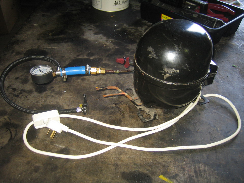

We got hold of an old fridge compressor and have played around with it a bit. The most we've taken it to is approx 160psi, next step is a bigger gauge and higher pressure testing.
A bipod is on the way and will be fitted.

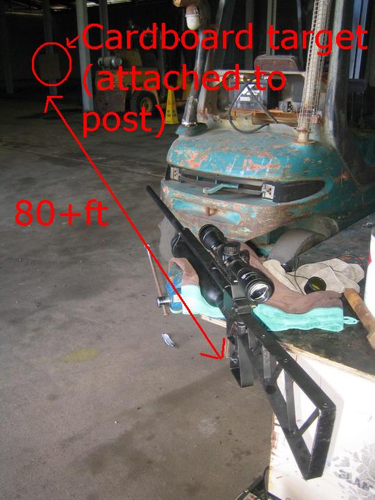

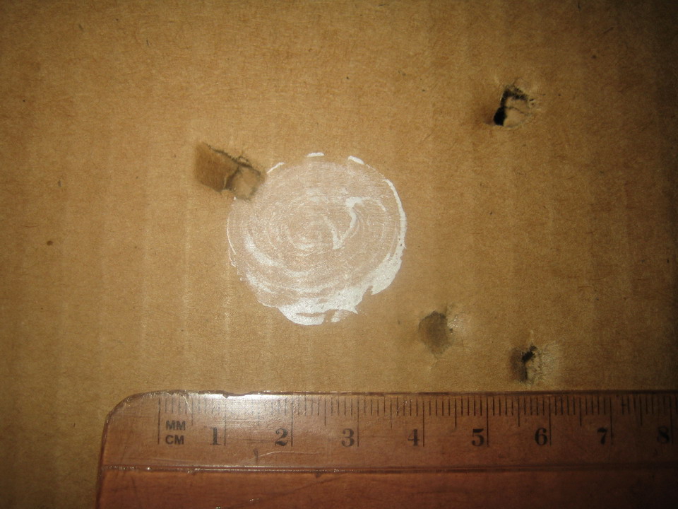

So far we've only tested the accuracy to 80 feet, and we can get approx 2" groupings. Part of that is due to human error and the fact I've only got a 4x32 scope. I might vice mount it and get a real accuracy reading (and buy a better/bigger scope).
Lastly I have to mention this was a two man job, my workmate deserves alot of the credit.
I've probably forgotten to include a lot of information, if anyone has comments/questions/criticisms I'm all ears. I can also provide more photos but there's no interesting home made pistons or anything.
Thanks for reading.

Much better than your previous effort! Please tell me there are some holes in the muzzle end to bleed air into the shroud
600 psi gauges can be had for not so many of your finest Australian dollars, crank it up to 450 psi or so (about the most that blowgun will take without leaking) and you will be fapping at the results of the power difference
The chamber is far too big for a single shot though, consider purchasing a slide valve and adding a secondary chamber to make it a repeater.

OMG... that's pretty amazing
I really like how you bent metal to form the stock, pistol grip and the rails (ohh btw what did you use for that and where did you buy it?) ->> look ppl that how you do stuff

Wow that was quick. Thanks for the suggestions, JSR. Shouldn't you be in bed though???
I have not drilled holes in the end of the barrel, that's a good idea, should have done that before I rifled it.
Just ordered a couple of those 600psi gauges, thanks for the link, they'll come in handy.
Ahh I was wondering what the magic number was for the blowgun pressure. 450 it is then.
Yes I realise the chamber is wayyy too big, just had that bottle lying around and I liked the look of it. Also it was a bit of a f-you to my old gun that had to have a tiny chamber so I could pump it up with the shock pump.
I have thought about turning this into a repeater the way you described, but I'm so sick of taking this thing apart I think I'll save that for the next attempt.
Thanks again for the suggestions.
Hi Poland Spud, and thanks.
Just like the last one all I used for the stock/grip/frame was 20mm flat aluminium bar. It's easy to bend in a vice and pretty forgiving. I screwed all the other parts together first and laid it out, then every bend I made I just checked to make sure it would actually fit the gun.
The rail is just 10mm aluminium flat bar. I used a bench grinder to bevel the sides so the mounts would hold, and riveted it to the frame.
I hope that answers your question. Thanks again.

you could put a small hole in the piston and a spring behind the piston, then if you tap the blow gun you should give you semi. Just like BTB didhere

Looks great! Much better power then the last one I assume. The chamber is way overkill for a .25 barrel you could have one 1/4 the size without losing much power, and plus, itd be much easier t charge with a shock pump
