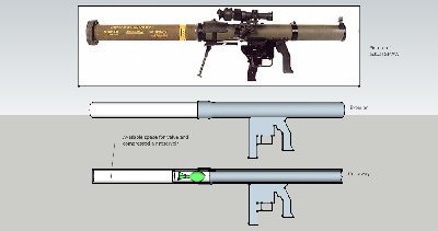

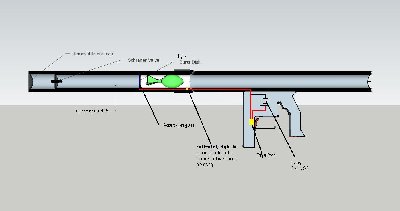

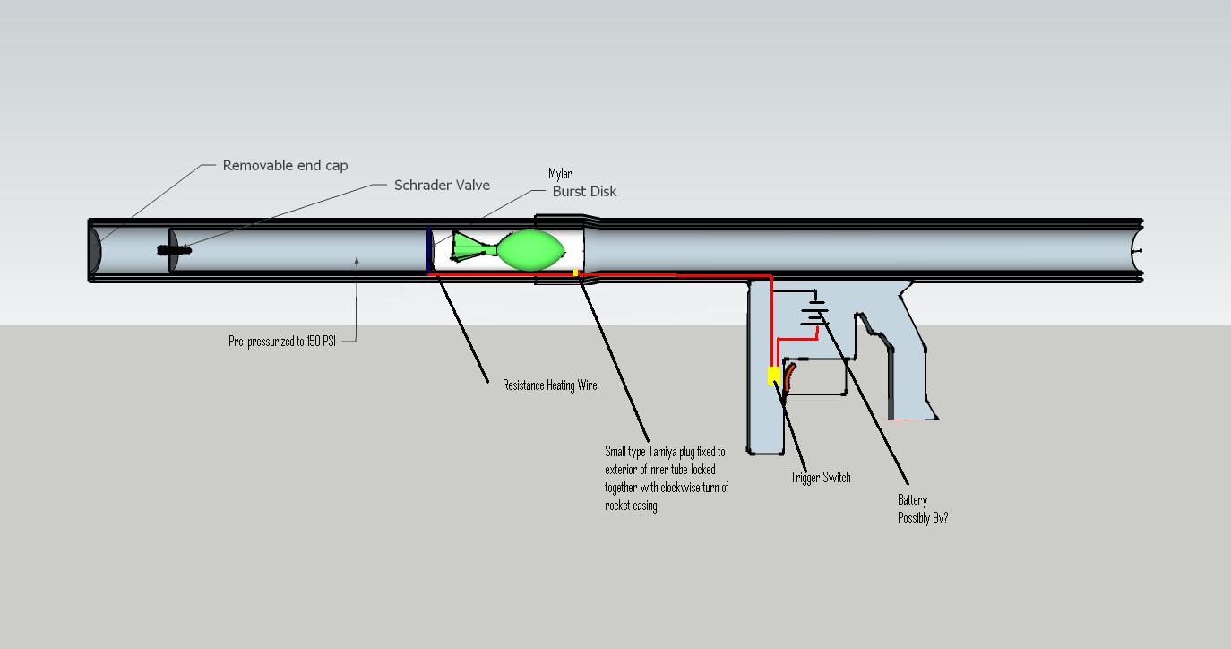

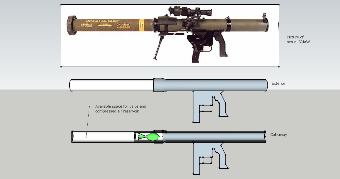

First, a little background: I recently attended Oklahoma Invasion 6, a very large MILSIM airsoft operation. My squad and I were advancing along a road with a friendly SpecOps fireteam. We get orders to reroute to a different position and as we leave, we warn the SpecOps squad about an APC rolling on their position. A little while later, we go past a group of enemies bleeding out and talking about how some SpecOps guys ambushed them with a couple AT weapons.
The thought of having that much firepower made me want to be our squad's AT gunner, so I began to hatch ideas for one and thought about the SMAW launcher. I have a significant portion thought up, but I am having a hard time coming up with an idea to connect the trigger to the valve in the removable rocket casing in an effective way. I plan to use 4" belled end pvc pipe for the outer body, and 3" belled end pvc pipe for the chamber and barrel. I want to be able to attach the rocket shell and fire without having to fumble with connecting anything on the inside of it.
Is this a possibility, or am I thinking to large?
Sketchup model with picture, exterior model, and cut-away model<br /><br />Blue parts are the launcher, which is made up of barrel, grip/trigger, and eventually, an optical sight<br /><br />White is the rocket casing

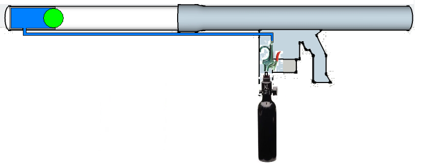

jackssmirkingrevenge wrote: One option could be having a small HPA bottle in the grip with a 400 psi or so output, trigger would be a blowgun and cartridges would have a burst disk or friction breech so they would simply have to be closed tubes with some perforations for air, conceptually like this..
Just to make sure I am understanding this correctly, this would require moving the chamber forward to be more above the grip than behind the shoulder, correct?
Thu Jul 07, 2011 2:46 am
Berkut wrote:Just to make sure I am understanding this correctly, this would require moving the chamber forward to be more above the grip than behind the shoulder, correct?
Not necessarily, I attached a diagram of what I had in mind. It needs a reasonably airtight seal on the cartridge in order to allow an overpressure to pop the projectile like a champagne cork.
You could either have the cartridge lock in place, or be blown out on firing. The latter will decrease reload time but will be to the additional peril of whoever is standing behind you...

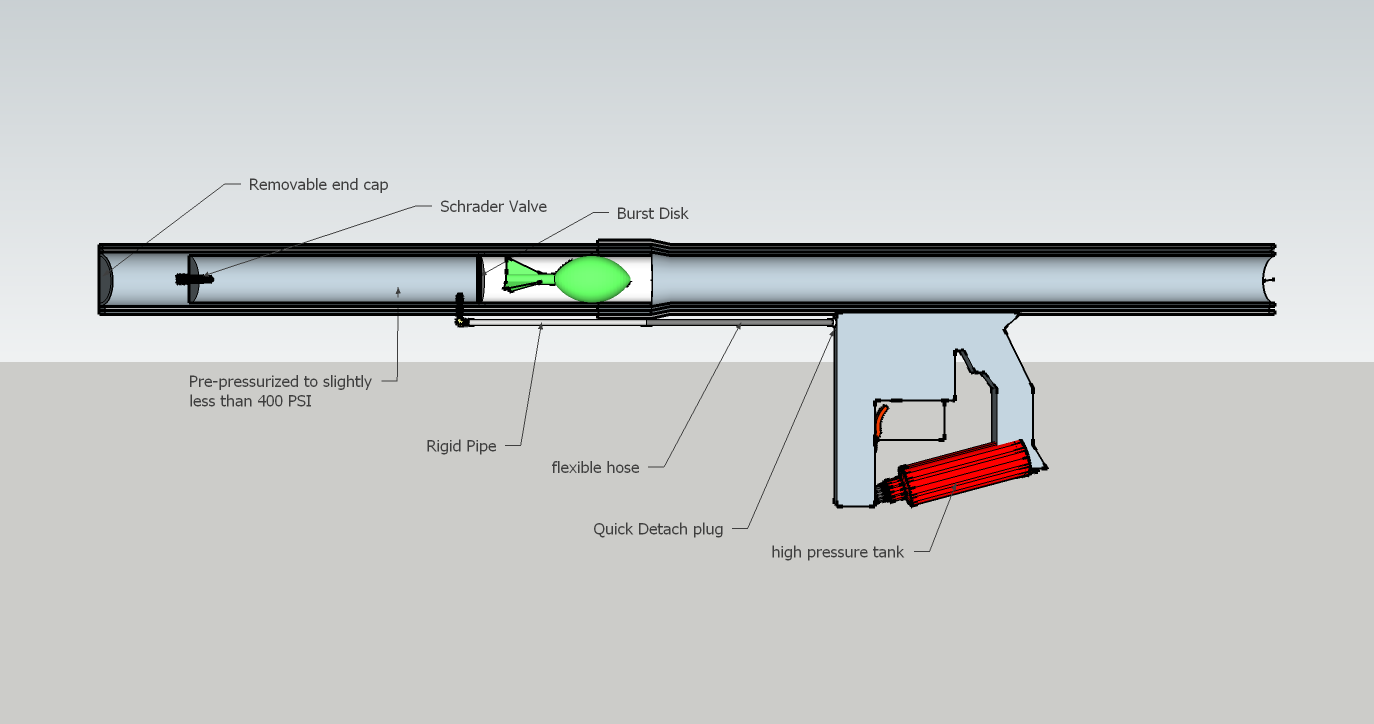

I would like for the casings to have a fairly self-contained propulsion system. perhaps the casings could be pre-pressurized and the tank would push the pressure over a burst disk's threshold like in the attached image?

Berkut wrote:No, not regularly at least.
you could use a trigged burst disk

I like the idea of the triggered burst disk. An electrical trigger for the burst disk would be perfect for this launcher. I looked into the resistance heating wire the spudding handbook talked about, but I would like to avoid ordering it online. Is there a better alternative, or at least somewhere to look locally for some? Has anyone tried the wire burst trigger set up?

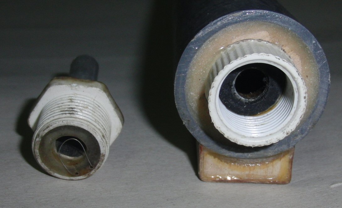

Fri Jul 08, 2011 4:10 am
Berkut wrote:Has anyone tried the wire burst trigger set up?
I had tried it a long time ago (sadly the image link is dead) and it worked pretty well, basically I used mylar tracing paper as disk material, holds pressure well and fails consistently when heat is applied.
A good source of wire is an old heat gun or hair dryer, there's tons of suitable nichrome wire inside.
There are several other ways of making self contained cartridges using a variety of valves, it depends what resources you have to hand in terms of materials, tools, time and money.
Have you confirmed that combustions are out by the way? With a simple 1x combustion you have the advantage of not needing a pressurised mix in the cartridge.

In the wire burst disk, does the wire break when the disk ruptures? and at approximately what psi does mylar rupture?

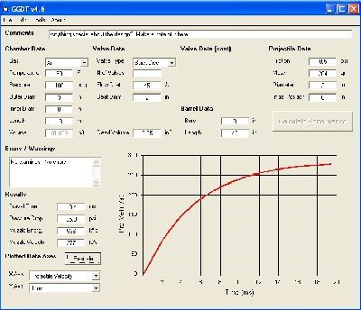

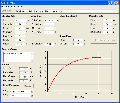

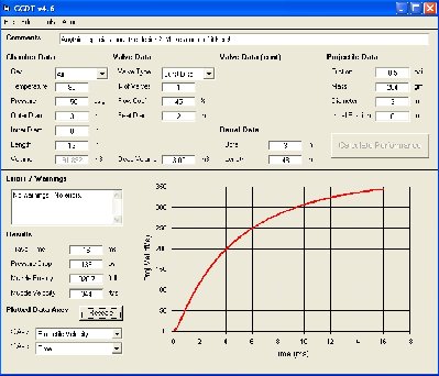

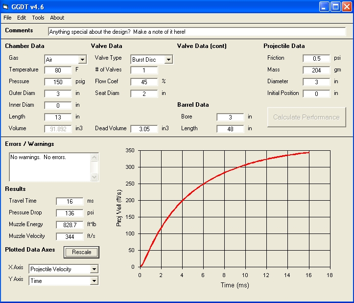

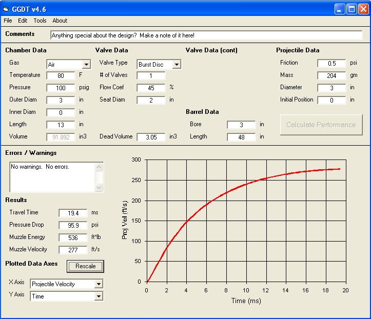

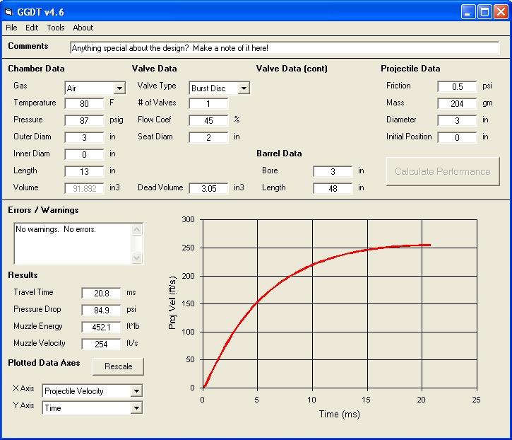

I used trial and error in GGDT to approximate the minimum PSI for my barrel to about 87 PSI. Here are GGDT screens at 87 PSI, 100 PSI, and 150 PSI.
Unfortunately right now, I am not at home where my sketchup file is, so I had to modify one of the images I uploaded using paint. It isn't great, but it gets the point across.

Berkut wrote:In the wire burst disk, does the wire break when the disk ruptures? and at approximately what psi does mylar rupture?
I would expect that the wire does not break, but it may so I'd be ready to replace it if it does. The mylar will rupture at a different pressure depending on how large the disc is. Just try it and find out, I suggest.

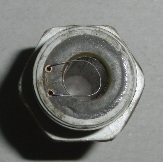

Fri Jul 08, 2011 8:26 pm
In my experience, unless you overload it, the wire won't break. The bursting pressure depends on the diameter exposed to pressure.
After a brief rummage in the scrap box, I managed to dig up my prototype. Note how I inletted two brass tubes to make the wire replaceable.
