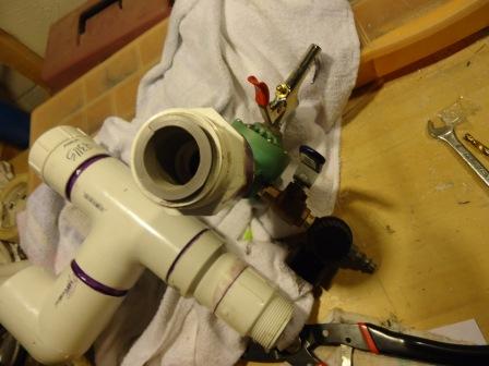

This is my new design of the Semi auto golf ball cannon. The valve was designed with the help from a few people, especially Gun freak, so thanks for the help. It uses a 3" tank that is 2' long. it is threaded into the valve, so I can change it out for something smaller of larger if I want. It is using a 1.5" threaded barrel, so I can interchange them as I please. The valve is a 2" piston valve, with 1.5" porting. I have yet to shoot it, but as soon as I do, the footage will be up. and when I get some time it will get a much needed paint job. [youtube][/youtube]

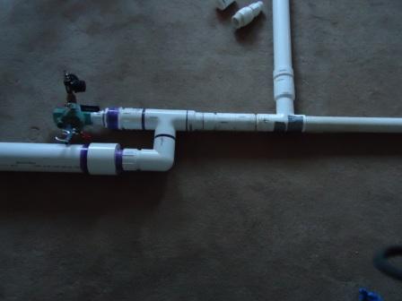

Full picture of cannon

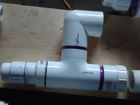

Piston housing, main valve

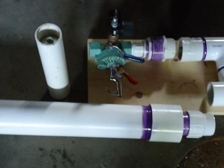

Chamber and pilot valve

Why is there primer on the outside of the male adapter :lol:
Erm... why did you use the 2"x1.5" reducer? It is supposed to be a bushing...
Looking good otherwise.

yeah, I primed everything first, and realized I primed the outside as well, oh well it is getting painted anyways, and I couldn't find a bushing while shopping, so I went with this, and the reducer wont make any difference, since it is still pressure rated

Nice job man! In my opinion, primer stains are a good thing cuz you know you got a good seal. What are you using for a piston and bumper?? Lemme guess, bolt and washer piston and a half a tennis ball??? :lol: :lol: :lol:
Going by the short socket depth, I'm gonna say the opposite.

It is actually pressure rated, I made sure before I bought it, i know it may not look like it, but it is actually made for use in high pressures
Tue Sep 13, 2011 10:46 pm
I don't mean to be anal but are you sure it says NSF-PW on the fitting? If it says Sch40, it doesn't necessarily mean it is pressure rated as Sch40 is not a pressure rating system.
Just checking, nice cannon by the way :wink:
CannonCreations
Posts: 57
Joined: Fri Sep 02, 2011 9:30 am
Wed Sep 14, 2011 7:00 am
Yes, I am 100% positive that the reducer in question is pressure rated, and yes it does say NSF-PW, and thanks, I am also a big fan of your work

No actually I am not using a tennis ball as a bumper, although i did think about i am actually using a rubber gasket, ill post it up top
