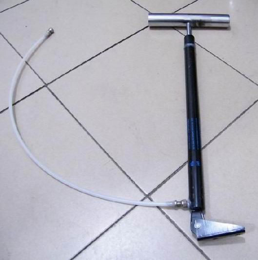

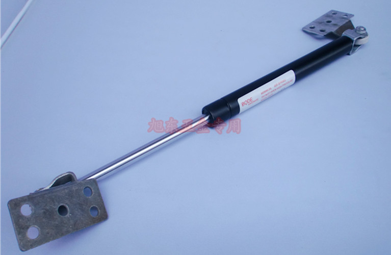

In China,Buy a refrigerator compressor to $ 70,
I chose a relatively low cost "gas spring" to transform
Cost is only $ 3

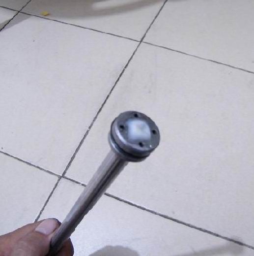

Mon Mar 12, 2012 10:54 pm
:shock:
Brilliant
idea! Ready made piston head, pump body, and that can take a lot of pressure!
What pressure can you reach with this setup?

jackssmirkingrevenge wrote::shock:
Brilliant
If the transformation is well, you can hit 4Mpa
Tue Mar 13, 2012 12:23 am
580 psi for the non metricated, impressive!
You can remove one from an old fridge
Brilliant idea! Ready made piston head, pump body, and that can take a lot of pressure
so it seems... not a bad idea
Could you explain how to 'transform' it?
(how to modify it into a pump)
Tue Mar 13, 2012 1:10 am
POLAND_SPUD wrote:Could you explain how to 'transform' it?
Seems fairly simple - drill a hole in one end and add a check valve.

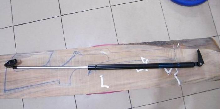

Wow thats a great idea, i am right in thinking that those are the things on the boots of cars right?
Wed Mar 14, 2012 12:39 am
killerbanjo wrote:I am right in thinking that those are the things on the boots of cars right?
Yup... you want to find one with a relatively small inner diameter (sub 0.75") and long stroke to be a useful pump. Or you can get that fridgy working ;)
