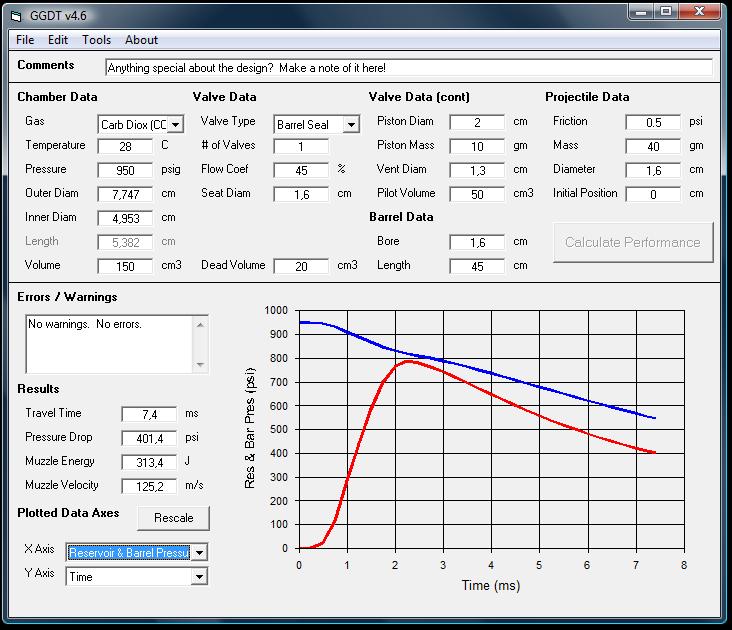

I would like to build a gun to use unregged co2, ggdt simulation bellow;

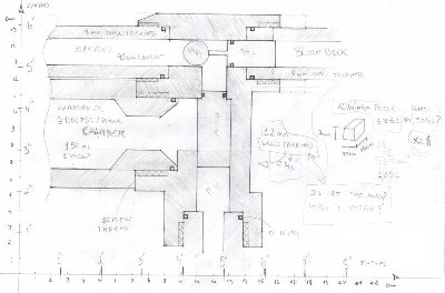

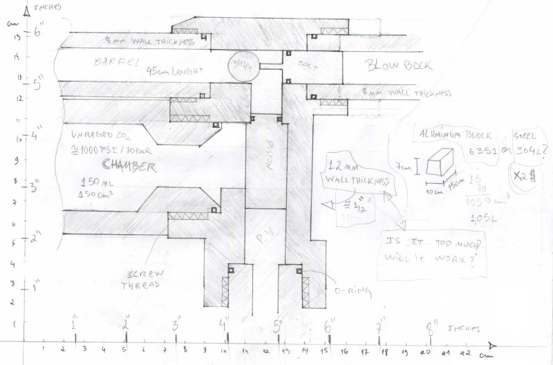

I made a draw of the piston valve:
I´m afraid to use that formula( P = (2*S*T)/((O.D.-2*T)*SF)) to calculate wall thickness... this formula is meant to be used with pipes, and the geometry of a piston valve is diferent. I dont know how to use software like solidworks, so i can not simulate it, but i can draw it in auto cad.
So my question are:
-what is a safe wall thickness to be used with each material (something that its built and did not explode :) )
-how deep the threads needs to be (in the drawing it is 3mm, some places 2mm)
in the drawing i used 12mm wall in chamber and qev (cos it need to hold pressure) and 8mm in barrel and blow back cos it will hold pressure for a short time. These values are totaly arbitrary and massive. It is also missing the detent of the bullet and the detent of bolt.
Sorry for bad english and for bad pics... and thank you!
Draw

ggdt
ggdt

I don't think your valve will open very well as drawn, you need a stepped seat to get it to pop open effectively

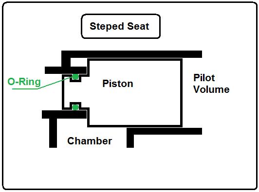

you mean something like this?

much better, the air needs some surface are to push on to initially crack open the valve. On another note, you've got all the o-rings in your design, why not put a floating o-ring on the piston body?

In the schematic draw, the seat is not stepped, but i dont know in fact if it is or not; i agree with your logic, there needs to be surface area to be the force, but what would happen if not? not open? slow open? once it begins to open the area exposed to pressure increases, so the force is big, and the open is not slow. but wil it open?

On your orignal drawing, the piston is stepped. The O ring moving seal is a smaller diameter than the piston in the Pilot. These are the two diameters used to calculate the forces on the piston. When the force from the chamber forcing the piston into the pilot is greater than the force pushing the pistion into the valve seat, it will open. Force is a function of pressure times area.
With the pilot under pressure the force pressing on the valve seat is high. As the pilot pressure is vented toward zero, the force is removed from the seat and depending on the ratio, a point is reached where the force pressing the piston into the pilot is greater then the force holding it closed. This only happens when the diameter of the seat is smaller than the diameter of the pilot end of the piston. If they are the same diameter, there will be no opening force. My valve requires a mechanical force to open it due to the 1:1 diameter ratio.

I also discovered that can only buy a 3´´X 3´´ block of aluminum, so i will have to redesign the valve, wall thisckness will be 6mm...
An autocad model is under construction, when ready i ll post here!
