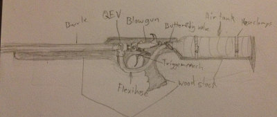

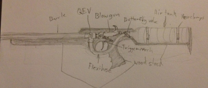

Anywho, this is a pic of what im planning to do but just wondering if its logical and reasonable to make?
Any help would be appreciated greatly :)
Sorry for the poo drawing :p and yes i spelt barrel wrong also schrader valve not labeled but between qev and blowg -_-
Thanks
HD

I like the design except for the hose that will reduce air flow causing it to less powerful. And Is the air tank going to be a soda bottle?

8ton....the hose is the reservoir (firing chamber). :wink:
Would personally prefer that to be made of metal (suitable tubing or pipe and fittings), but otherwise no real issues with it.

Gippeto wrote:8ton....the hose is the reservoir (firing chamber). :wink:
There is a problem, from the position of the fill port, it's a unmodified QEV. And that means he can't refill the secondary chamber from the chamber side. Drill a 2 mm hole on the QEV's piston and add a light spring behind it will solve this problem.
If his main chamber it's soda bottle, there is no need to use metal fittings for it.

Okay so how about modded QEV, then instead of blowgun i put like a air safety release valve straight onto the QEV?
Then i can fill from another port such as putting a schrader valve on the tank? :3

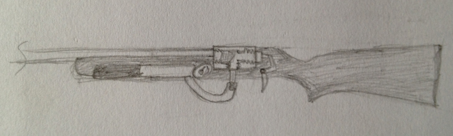

Here is another design i was thinking with a bike pump attached, constructive criticism would be appreciated.
Thanks
HD

Awesome thanks jonesy42 :) what you you think about the design?
The barrel inside dia is 7mm so custom ammo and bbs, there is no chamber in the second drawing i was thinking of using the pump as the chamber, do you think this will be enough or should i fit in a elbow to increase it?

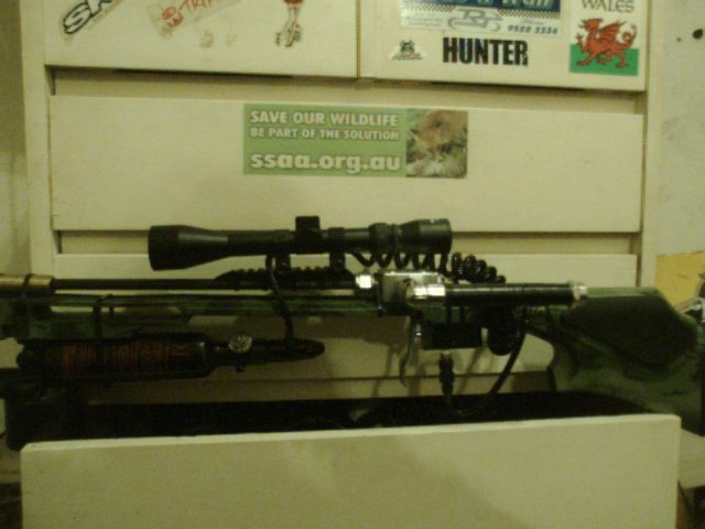

@harridawwg.... Nice, looks a bit like a Air Force Talon , in the drawing with air tank in the stock).......
Im not sure what you mean with the pump etc though?

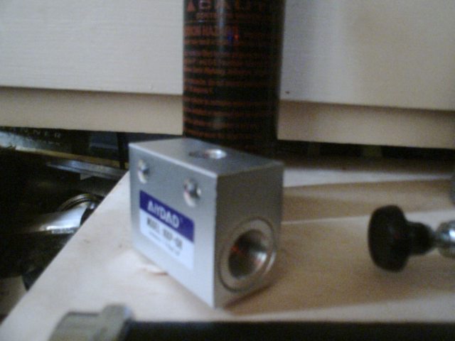

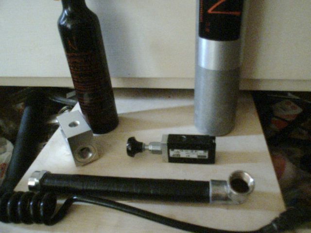

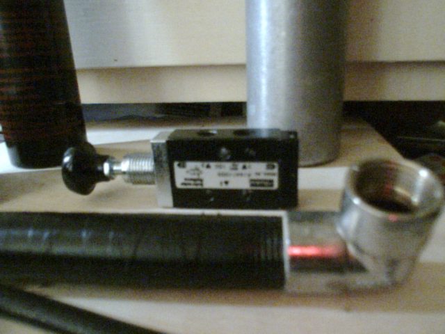

Here are some photos of the main parts i use for my semi-auto qev rifles.
I use a 6mm barrell and 9.5mm.
All the gear fitted to my old crossbow stock
parker 3 way valve ( i got this one cheap around $30)<br />There are cheaper brands on ebay if you look around.
ninja paintball tanks, regs and remote lines (around $100 for the small tank, reg and remote line.<br />Half inch piece of galvanised pipe for &amp;quot;firing chamber&amp;quot;<br />This &amp;quot;firing chamber&amp;quot; is a little long though, a<br /> 200mm length is plenty for what you need.
Half inch piece of galvanised pipe for &quot;firing chamber&quot;
This &quot;firing chamber&quot; is a little long though, a
1/4 alloy qev valve $12 (ebay)

With the pump in the second pic would be the chamber per say but i highly doubt its big enough, so i was thinking an elbow would allow enough space?

HarriDawwg wrote:Awesome thanks so much jonesy42 :D
Is that a bike "shock pump" you want to fit in your forestock?
I am not familar with how they work, but im sure someone could
give you some advice on whether your theory would work or not.
Would you not have to pump it up after every shot though? Sounds
annoying to me lol!... Have you thought about running it with C02?
You could put a small c02 bottle in your forestock instead, then you
at least get a few shots out of it without having to pump it up after every
shot.

True True, i was thinking it wouldn't be to bad as it would be a small chamber therefore not to much effort to pump it, but a bigger chamber or using co2 would be better.
Using a butterfly valve would suffice to use it for multiple shots hmm design rethink i think ;P
