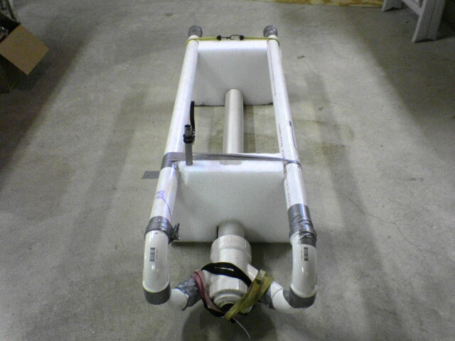

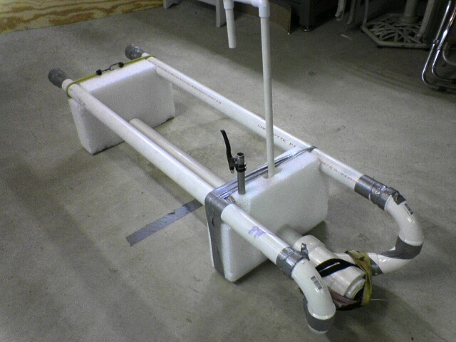

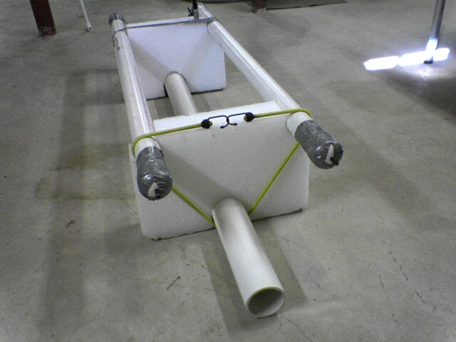

<div align="center">THE ALPHA UNIT
Here's my Alpha Unit. I'ts the first cannon I've made and incorporates my own super high flow valve. It shot a tennis ball with loose foam wadding about a quarter mile at 60 psi. The barrel is 3" with a 4" valve (yes it is indeed 4 full inches of flow!!!!) Two 2" ports dump into it as you can see from the dual fill chambers. The first test I made with it was at just under 30psi and the valve opened so fast it blew it right out the back of it. So that's why there are straps holding a modified plug on the end of it so it still works. Oh, and the duct tape is for looks :)
~Andy

It used to have a lever trigger

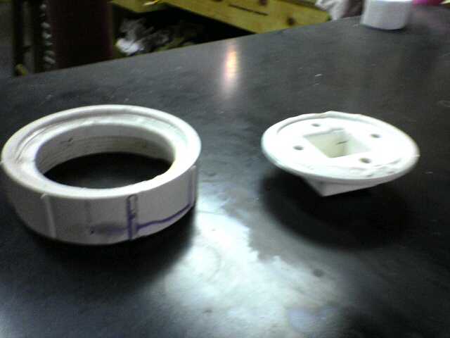

looks cool but the reason the plug blew is because its NSF DWV, or not made for pressure, so is that double Wye you have on there, and the elbows. you should really use NSF- PW fittings only, as they are much safer, i'd be intrested in knowing how the valve works exactly, maybe some paint drawings or auto cad renderings?

I think it might be a barrel sealing valve like in a copper piston but just with two inlet instead.

Your quarter mile measurment wasn't done very well.
I opened up calculator, and calculated that in an ideal system - no flow losses, no pressure loss during firing cycle, no wadding mass... a simple 400 some pounds of force for the full 10' of the barrel... your velocity is about 335 m/s.
I then opened the GGDT and made a launcher (uses 195 psi hydrogen through a burst disk, if you are interested...) that gets the same velocity with a 53 gram projectile.
Using the GGDT's built in flight simulator, and a Cd of .3 - which is way too low - I got a range of ~1/6 mile. I have to use a Cd of .18 to get .25 mile, which is moving in on dart territory.
So, in conclusion, it is compleatly impossible for you to have shot 1/4 mile with a tennis ball, unless you weighted it or something. If you did, I'd be happy to recalculate...

looks like a first timer all right. be careful when you purchase your piping, always read down the pipe to make sure its pressure rated. its a pretty creative design, however i think it would be a little better if you didn't have the barrel on the bottom.
