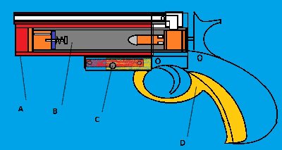

Lately I have been pondering over some exotic idea's.
One came from my desire to build a compact pump pistol.
While an integrated pump offers free pressure and a sense of independance it has a downside.
Lets take some crosman pistols as an example..
The disadvantage in terms of compactness ,of the well known Crosman 1377 pump models ( I owned one)to me, is that the pistol is longer than it's cousin, the CO2 bulb powered 2240.
Ofcourse, this is due to the room the pump assembly takes up.
I came up with a rather exotic idea.
Why not cut off the front leaving the checkvalve as the most forward part...and sleeve a housing over it.
machine some O-rings in the original reservoir and by sliding the sleeve forward, have it suck in air.Push it back and air will be compressed into the reservoir...right?
this means the pistol can be shorter with the sleeve compressed.
A lever, in my concept an extended triggerguard would pull back the outer sleeve and basically work just as well as the traditional pump lever.
It's all just flipped around and reversed.
Ofcourse I don't mean to do so with a crossman, I'd rather build my own pistol along the lines of my lever action.
I figured a barrel sleeve on top of the external pumpsleeve would offer stability...and function as a breechloader opportunity.
This could really work well in a single stroke pump design, if you could live with the lower powerlevels.
In that case you could have it load a projectile automatically apon each ( single) stroke
The same idea would help to keep a pump up- linear hammer design fairly short.
Offcourse the lever could be placed back over a shoulderstock if you'd like to.
Another plus ( I think) is that you'll have no slots cut out of the tube.
So I present:
The EX-tegrated pump:

- ( I understand the various parts of the leverarm are not very clear, but I tried it and it extends and contracts the outer sleeve while offering mechanical advantage to overcome the raising pressure, just like a normal pump would)
A is the moving outer sleeve, B is the fixed reservoir, C is the pivot for the arm and D is the arm itself.
The red scetchy bits connect the arm to the sleeve.They interlock.
That alone is great to hear, seriouslyBrian the brain wrote:Lately I have been pondering over some exotic idea's.
I like it, the chamber though would have to be pretty small diameter in order to make the forces viable for manual pumping. Also, it's quite a short stroke so that's a lot of pumping to get the sort of bar one usually expects from your projects...
Remember that the Crosman 1377 has a tiny, one shot chamber:
If you want more than one shot from yours, that's going to be quite a bit of exercise...

A logical response..I like it, the chamber though would have to be pretty small diameter in order to make the forces viable for manual pumping. Also, it's quite a short stroke so that's a lot of pumping to get the sort of bar one usually expects from your projects...
The forces involved can be overcome with enough leverage.
A 25-30mm diameter should pose no problem from what I've learned with the Lever-action.
( did I ever nickname that one?)
The drawing is by no means to scale..
The distance between the front of the checkvalve and the connection to the barrel could easily be up to 15cm.
With an expected stroke of about 11 cm I'd say it would surpass my latest build when it comes to pumpvolume.
It remains to be seen how much leverage would suffice and how short the stroke can be to still be effective.
It doesn't have to have multishot capacity from a single filling.
I'd do 20-30 pumps per shot if I had to in order to get the compactness.
all dimensions aside, the EXtegrated pump idea will still eliminate the need for the usual added pump length.
The simplest solution would be a detachable pump, but I want the best of both worlds when I know it's possible.
In my marriage I'd like the same ...wife says that's not gonna happen...In this case I set the rules..

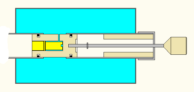

If it's just for single shot, why not forget about the lever and just use a small bore pump? You can get to silly pressures in a small chamber, and as we know small volume high pressure vields more power than large volume low pressure.
Remember this? https://sites.google.com/site/inov8ived ... icropistol
Say you used a tiny bore, 3mm. Taking it to 400 bar will require less than 30kg of force...
Actually, now that I have machine tools to go with my SCUBA tank, a "proper" HPA (in the 200-300 bar operating range) launcher is long overdue... so many projects, so little time!

I think your missing the point....If it's just for single shot, why not forget about the lever and just use a small bore pump? You can get to silly pressures in a small chamber, and as we know small volume high pressure vields more power than large volume low pressure.
Same reservoir volume with a similar amount of strokes to reach a similar pressure without the extra length.
That's the idea.
If you remember my "pirate pistol"...a short coax basically..?
I remember using the barrel as the pumptube and the piston as a checkvalve...Pretty simple idea..
IT TOOK FOREVER!!
And still the short stroke and diameter meant low endpressure.
Dead volume and loss weigh heavily when things are small...
Fair point, I'm just averse to levers I guessBrian the brain wrote:Same reservoir volume with a similar amount of strokes to reach a similar pressure without the extra length.
That's the idea.
That's brilliant! Bloody hell, if the pump head is flat dead volume would be practically zero!
I had to dig upthe thread to check if I had missed it but it doesn't seem you mentioned it.
Might not be practical for a largish bore short barrel, but for say a 0.22 with a 15 inch barrel...

edit: What if you use a QDV, and incorporate a check valve (a schrader will do...) into the piston opening to the face...
Here's a quick sketch (based on an old Labtec QDV drawing
- barrelpumpedQDV.PNG (6.77 KiB) Viewed 6246 times
- wyz2285
- First Sergeant 2
- Posts: 2388
- Location: Porto, Portugal
- Has thanked: 1 time
- Been thanked: 4 times
If I remember correctly, a schrader´s open pressure is around 1bar, the piston of the QDV would have opened with that pressure in front of it? Unless a locking mechanism on the trigger rod to temporally hold the piston in place.
Actually more around 4 bar... I just put that there as an example, but a custom check valve with much lower cracking pressure can easily be made with a steel ball and an o-ringwyz2285 wrote:If I remember correctly, a schrader´s open pressure is around 1bar
The way I see it, you would be resting the launcher on a hard surface while pumping, properly designed this would keep the piston in place.Unless a locking mechanism on the trigger rod to temporally hold the piston in place.
I'm tempted to make this but every time I think about a single shot pneumatic the thought comes to me that "If I made this a hybrid instead, it would be more powerful..."
