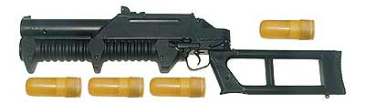

To be more specific I am looking for an ELECTRONIC FIRING SYSTEM or some form of a TRIGGER SYSTEM. Only there is a catch I am doing a mock up of a GM-94 Gernade gun and I am trying to enclose as much of the workings as possible. So I was wondering if anyone here has any ideas on how I should go about this. Any Valves that work really well. Things people have tried. Anything would help. A push in the right direction. Oh and I forgot it needs to Be Pretty SMALL ( under 3' total length).

(this is what I hope to be close to when its done)

- GM-94 Gernade Gun.jpg (6.5 KiB) Viewed 1355 times

that shoudl be ablout all you need to know. To make it look like your pictured gun, you'd have to house it in a wooded stock.
