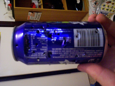

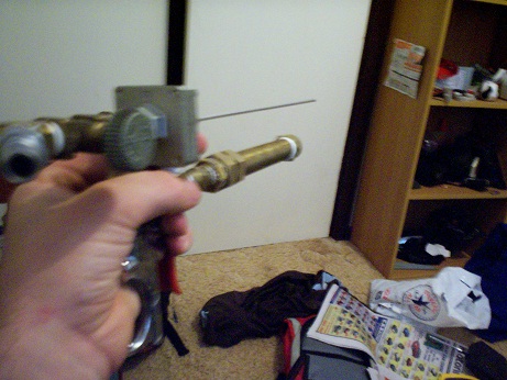

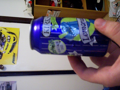

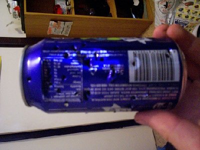

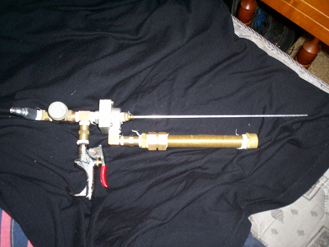

I have been using a 1/4" qev coupled with a needle valve and blowgun for semi auto fire for quite a while now (well when i say semi i mean muzzle loading semi...never had the motivation to make a mag for it. That was at 6mm. Now i thought id post a modification i made which was cut the chamber by half and add a 2mm aluminuim barrel.
Even with a barrel that short and running at 70psi i m able to get nearly through both sides of a coke can (at 80 it goes through).
Ammo is 1.9mm lead shot for shot guns.

Hey Carlman! That's nice!!! Any idea of the velocity of the projectiles? i'd say you can put a longer barrel, sleeved in a bigger pipe. it's impressive that you manage to pierce through a can, 'cause it takes a certain amount of energy to do that and would have doubted that 2mm lead shot would have it.
Won't you put it to a higher pressure? small projectiles tend to love the extra force behing them

Good stuff. I was contemplating hooking up the Rattlesnake valve to a 3mm barrel as with 500-800 psi performance would be impressive, but at the end of the day 4.5mm is a better idea, more muzzle energy and BBs are much easier to obtain.
If you want better penetration with this, try using "beheaded" nails as ammo
and as suggested above, higher pressures go a long way with smaller calibres.

Thanks guys, I dropped the 6mm for the 2mm for fun as I got the lead shot for free lol
Its hooked up to a compressor
I am using the qev off this for my competition gun, .177 cal
