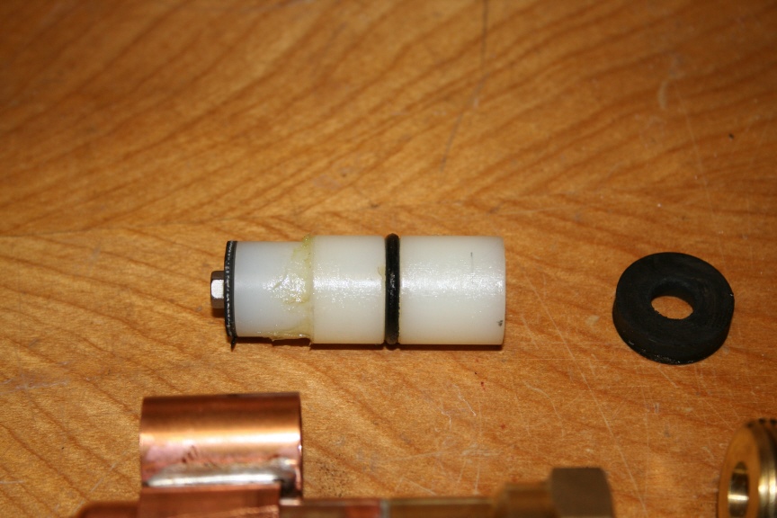

My piston. This is temporary, I will get a piston stop and a rubber for the front piston surface tonight.

The gun worked perfect yesterday, but today the barrel was leaking. I opened it up to check my piston and there is dents and groves where the barrel seats. So I will either have to put a rubber in front of the piston or use a rubber sanding drum. I wish I could machine one from some aluminium, but I don't have a lathe right now. Hopefully going to get a small one soon, so I can do some better stuff.
Wed Oct 02, 2013 6:59 am
Nicely done :) for the purposes of smoothing out your barrel seat, a power drill clamped in a vice makes a good extempore substitute for a lathe - bit of sandpaper and you're good to go.

Nice job. For the piston, use some stock that is long enough to grip from the back of the valve, cut your seating end flush with a miter saw, and attach some stick-on sandpaper, and go to town on the sealing face in the valve. It's how I got my piston valve to seal at higher pressures. A piece of rubber bolted to the end of the piston will help too.

I have this 7/8 x 1" square stock of some kind of hard plastic, but I have nothing to turn it with now, so I might look for some 3/4" round stock, and try to sand it to fit inside. One question. When people cut a notch in the piston and then put an o-ring. I thought you needed a notch in the piston for the air to transfer to the air chamber. So how does that work if the is an o-ring?

You can see after 10 shots, the piston surface is already caved in. so a better piston or rubber front is required.

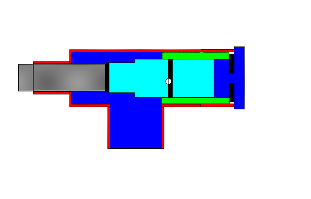

Notched piston with o-ring?
This?

Yes, does a small hole need to be driled in the piston?

i never realy did understand why people notch their oring slots pistons can you explain that.

The drilled hole lets air bypass around the o-ring for filling.
During piloting, the o-ring is against the un interrupted rear portion of the groove and seals...preventing any bleed air from the chamber from adding to the pilot volume.
