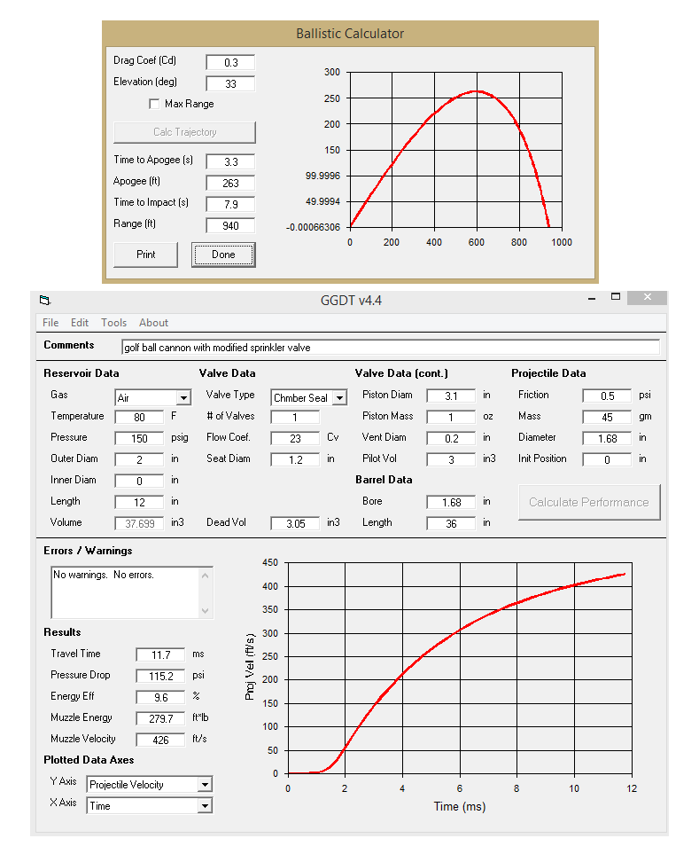

Here's a virtual launcher modeled in Gas Gun Design Tool:
I used a modified 1" sprinkler valve, 12 inch long section of 2 inch pipe as a chamber and a 3 foot long barrel.
As you can see we're in the ballpark of 300 yards range at 150 psi with a golf ball.
Such a launcher would be very easy to put together without specialized tools, there are plenty of examples of such launchers on this forum.
In terms of gas, I would advise against CO2 because of its temperature sensitivity, you're better off with compressed air.
A paintball tank would be ideal as a compact air source, you can get very good regulators from Palmer's Pursuit that will drop the 850 psi output to 0-150 psi easily. It's also advisable to get your hands on a low output pressure tank (or one that can be modified like those made by Ninja that can be dropped to 450 psi by removing shims) for better efficiency.
Given your situation, electronic actuation would be ideal as a switch needs minimum force, and it will also me more consistent, so you might want to consider a conventional solenoid operated sprinkler valve that actuates a second sprinkler valve.
