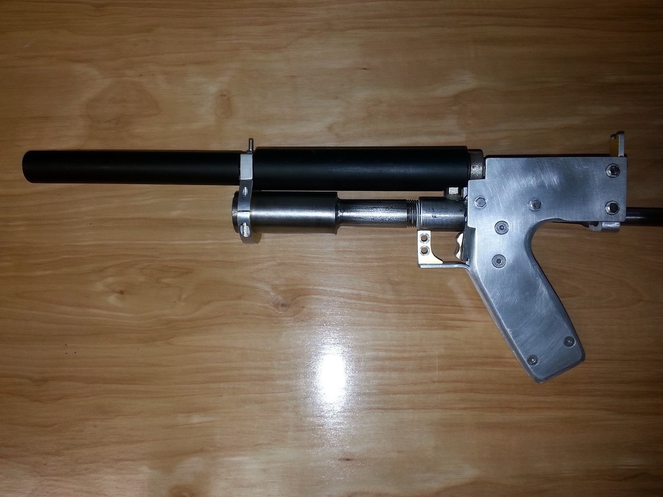

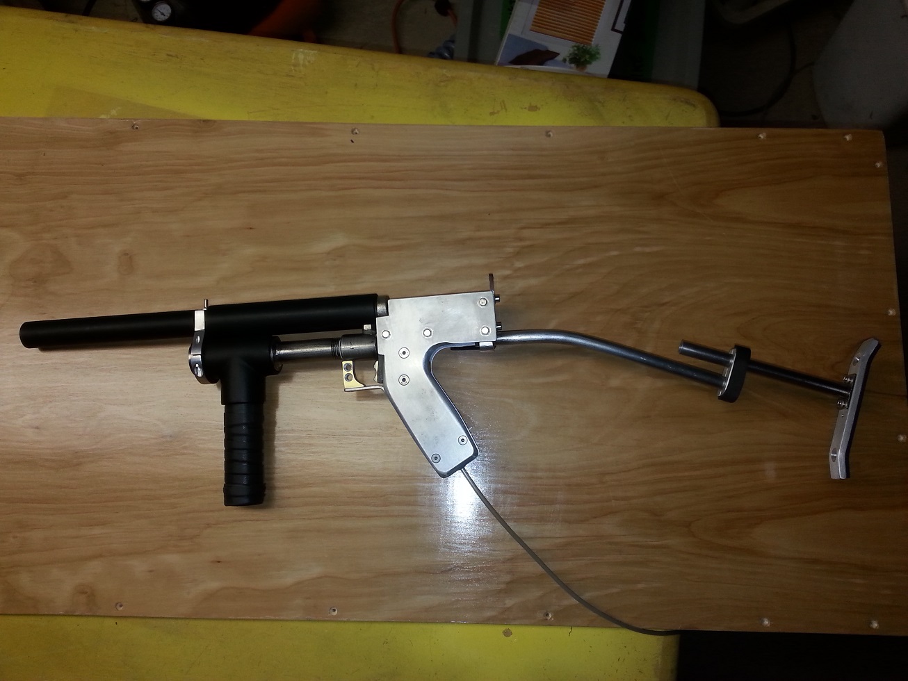

Sounds good, would like to see it. I also favor airsoft as the ammo is cheap and I can get good results with only 150psi from my compressor.
This gets 826fps with 0.12g :D
Mon Nov 04, 2019 6:09 am
Great work for a first effort, kudos for jumping in the deep end with high pressure, that's where the power's at :D
I would have gone for a 3/8" barrel for some proper damage, in my book 0.177" is good for semi/full auto repeaters and not much else, but you're still going to be getting some good velocities out of that.
What are you using to stop the ammunition from rolling out before firing?
def. pushing it for the valve
To be honest I wouldn't be trusting it at 850 psi regularly, assuming the working pressure is 150 psi and the safety factor is 4x, that's still 600 psi.
Have you tried looking inside the bottle regulator to see if there's any shims you could remove in order to reduce the output pressure?
Last edited by jackssmirkingrevenge on Tue Nov 05, 2019 10:31 am, edited 1 time in total.
