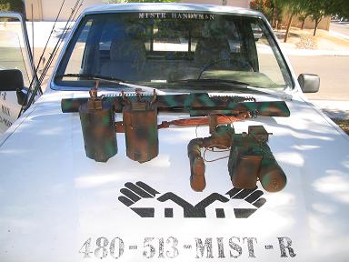

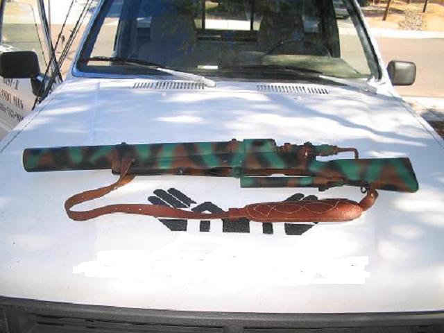

<div align="center">M79
ok the M79 is just a simple launcher. Co2 and a 3/4 valve for a trigger.
the toe popers are powerd by a 12 gram and realy shoot paint.
the claymore is a remote activated mine and well i just love using this baby, realy catches them off guard.
I have custom made shells for the launcher two types 1 is an anti tank round loaded like a buckshot round, i can get 150' and keep it accurate in a bout a 6' circlethe other type is almost the same thing but the shell breaks apart as soon as it leaves the barrel and shoots 15-25 paintballs great for anti personel or bunker busting. i use it to rain paintballs DOWN on the enemy and they should never be fired at a person or persons directly. getting hit with one hurts i would not want to get hit with 15 at once.
</div>
</div>
- M79.JPG (41.15 KiB) Viewed 20619 times
- landmines.JPG (23.85 KiB) Viewed 20616 times

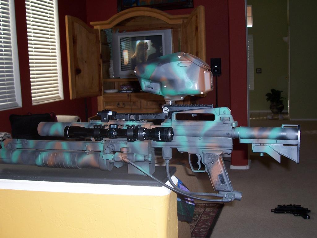

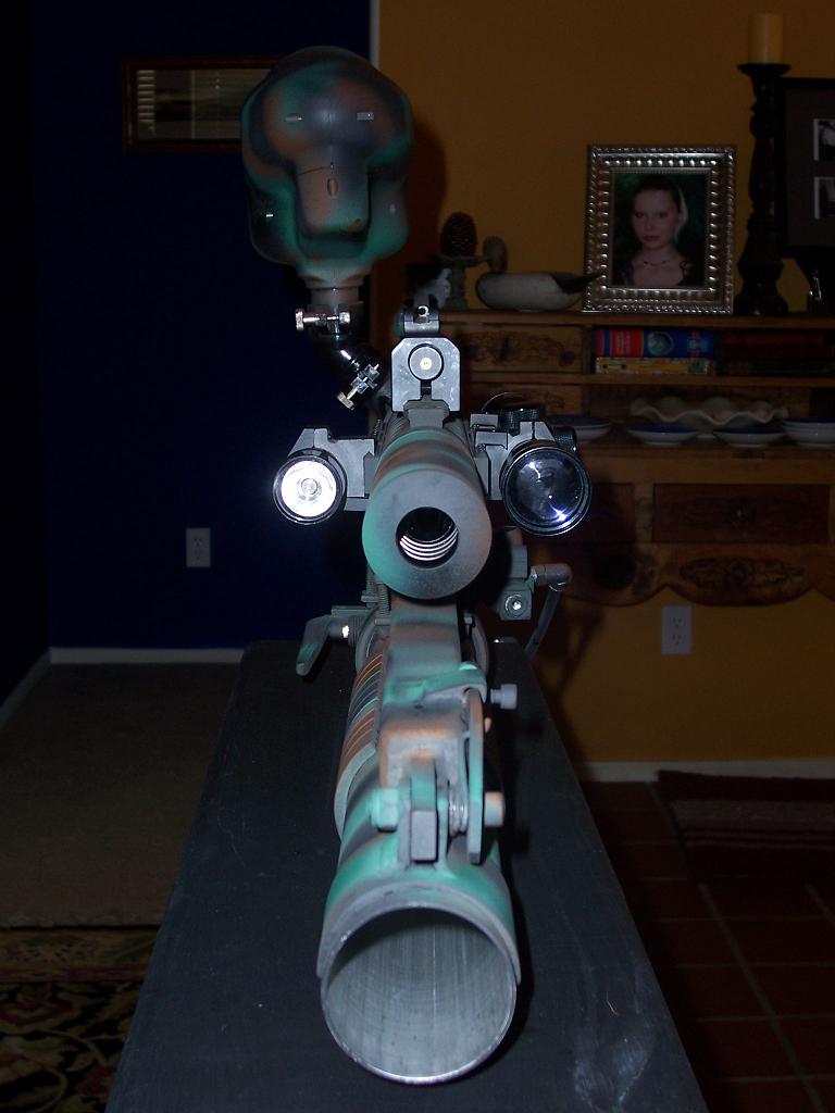

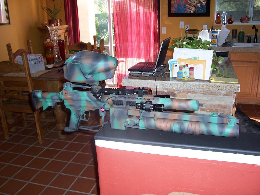

M-79 was the proto this is the final
- M203 side.JPG (96.18 KiB) Viewed 20553 times
- M203 rside.JPG (121.21 KiB) Viewed 20550 times
- M203 front.JPG (67.58 KiB) Viewed 20550 times

wow, that is pretty nice indeed, just a question, with the tube thing underneith the gun, does it really suck the air right out from you tank? and another thing... when you shoot it, do you use a solenoid as a valve? if so, then how do you turn if off
because I thought that once you actuate a solenoid valve, it will be one forever as long as the air flow is constant.

A soilnoid valve will only remain open if you keep it that way. Either by electricity, ot keeping the flow open on a pneumaticly modded one. Otherise, the pressure reseals it.

It is a gass hog. 375 psi to launch and i can regulate from 100 to 500 psi and it has a shut off. but as the last responce said as long as i keep my hand on the trigger it wil vent. takes a few rounds to get used to but it still is a major gass hog.

Wait, you have 375psi backed up behind that sprinkled valve? They are only rated to 120psi. I was wondering why I didnt see a chamber. It just fires strait from your CO2 tank then? That is wild.

hmmm, seems really rteally dangerous, but I think that they do have those heavy duty sprinkler valves that are metal and are rated for like 600 psi!!! now thats intense!!!

600psi? Really? Wow, the most i have seen on a brass sprinkler valve is 200. How large are the ones you are talking about, and do you have a link to them?

well I think that you may be able to find them mcmaster then again, maybe not but they are about the same size as regular ones except that they are made out of like stainless steel or something

well I hope that you understand how a sprinkler valve works right? well this is the same thing except that it is made from really really heavy duty material and some steel too
