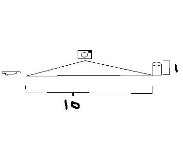

Edit: Okay, I calculated the firing speed to be about 500 fps based on the sound file he kindly send me. Here is a snap of the sound file with scale, so you can recalculate it as you wish from different points:

Um i calculated the speed to be 288.18 m/s or 945 fps.
You have to remember that the time it takes for the sound to travel from the target (10m away) to the microphone is 0.0303 seconds (speed of sound at 330m/s). So you subtract 0.0303 from 0.065 and you get 0.0347. So that is the true time it took to travel 10m (assuming that the microphone is held close to the gun).
Therefore 10 / 0.0347 = 288.18 m/s 945 fps (big difference to 504 fps)
Sorry to get all technical and stuff but remember that the speed of sound is quite slow so you must account for it to get an accurate measurement.

At face value I would say 945 fps is incorrect. It would simply not be possible for this gun design. Whether that's a calculation error, an error in measuring target distance, or something else - I am not sure as this is not my gun.

Whoa something in my head just clicked and it just occurred to me that 945 is SH*T fast. Well thats what i calculated using the diagram above, maybe it has been speed up. Or maybe it wasn't actually 10m.
Maybe someone should re calculate it because im quite tired at the moment, i could have easily made a mistake.

hey shud_b_rite, you're right actually. a lot of the things we hear are past. When you shoot a pellet rifle to a target at 40 meters, you here almost instantly your shot, and then, 1/3 " you hear it hit the target. actually, it hits it before. and your method is correct.
The simple example, is from where you're sitting. If you're sitting next to the target, the shot and the hit will seem to be the same.
and , you're actualy right cause i did some tests with my marble rifle too...
With the above method i had 700 fps. and considering the speed of the sound returning the hit noise, i had a beautiful 900 fps.
so, don't joke with marble guns, they are as powerful as black powder pistols.

The audio file was recorded one metre to the left of the exact middle point inbetween me and the target. I have also factored in the speed of sound into my equation. the round thing being the barrel(target)
