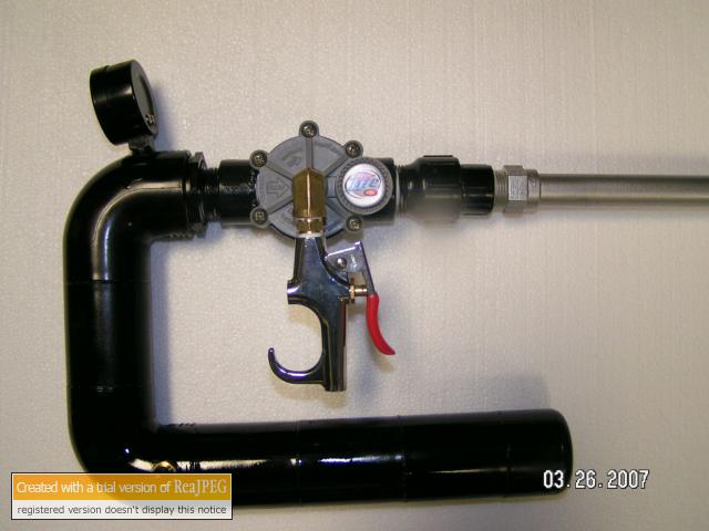

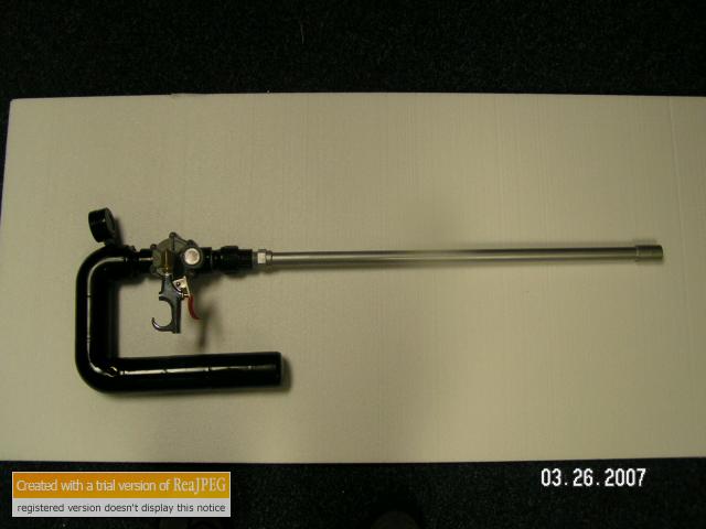

This is my first attempt at building a spud gun. I decided to go with a pneumatic gun due to the consistency factor they seem to have over combustions. I made the chamber of this gun out of 1 1/2" PVC piping. It consists of 4 couplings, 2 elbows, and 1 end cap. I am big into aesthetics and personally like the flush chamber style much more (Plus I believe it adds some safety value to it). The valve is a modded 1" Rainbird sprinkler valve w/ blowgun actuation. The barrel is 2' of 3/4"CPVC piping with a 3/4" coupling on the end. I have yet to include breech loading on it simply because Im not sure on the best way to do so with keeping it looking ok. I've only tested it up to 50 PSI since im not too sure how high it is safe to take one of this size. But the test fires more than pleased me. You can barely see the PB as it leaves. If anyone has any suggestions please let me know. Hope yall enjoy. Btw I appologize for the logo in the bottom left corner. Couldnt find a way to get my pics from BMP to an uploadable format.
Pic of whole Gun
Pic of whole Gun
Close-up of the valve

Unusual design, love the flush coupler look. Bet it's a fun plinker. :D

not bad at all shoot some lead sinkers see how they go.

one thought on your blow gun trigger.I had the exact same one and it didnt dump as fast as a different one i had around so you may want to see about getting a different one to see if you gain some power i know i did.very noticable differents.

I appreciate the tip Locksmith, I got a few more laying around my shop so I will swap em out and see if I notice a difference as well.

I really like your gun though. Excellent job making the whole thing flush. It looks better that way.

Great looking 1st gun (2 thumbs up).

that is a lovely gun it looks rely nice
the chamber looks sweet flush to
im looking forwards to ur next gun
