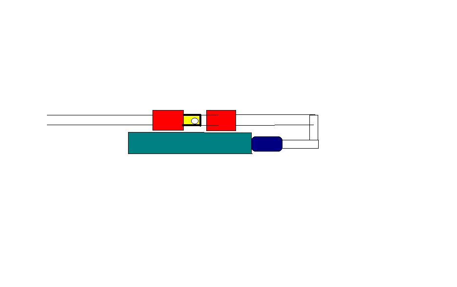

ive been trying to make a new rifle but i cant figure out a good way to get more than one shot out of a chamber(without halving the presure each time). The only way i can figure out how to do that is by having multiple tanks. Ive already made a new way of breech loading. It uses a slide repair coupling and slides through a 1.5 " pice of pipe. The good thing about this is it doesnt leak! decided gumballs will work perfectly in a 1" barrel. Is there a way to fit dual sprinkler valves into a single rifle?
blue- moded sprinkler valve
red- 1.5 inch pipe where the barell slides through
cyan-chamber
yellow- 1 " slide coupling
when its finnaly built with all its upcoming changes ill post pics
any help would be appreciated

Why don't you make a three shot tank and wear it on your back? you could have a hose run from that to the gun. have ball valves between the tanks. This would give you 4 shots because one extra chamber is on the gun. Also, for the "bolt", you should use a 1.5 inch coupling and sand out the ring in the middle, it would give a little more flow of air and would be just as tight. I would also be easier to load.
Yes, you can rig up duel sprinkler valves. you need to connect them with a tee and two elbows on one side and do the same on the other. (one for the chamber and one for the barrel. so in total you need two tees and 4 elbows. I dont think it would really help much though. it might give you a little more flow, but not much.
EDIT- just FYI, 1'' couplers don't fit in 1.5 inch, they are to small.

The bend will reduce the performance since it's just dead space. If you make the bend out of larger diameter pipe, and put the valve right before where the projectile will be, it will be more powerful.
To make a multishot gun, you either need multiple chambers, or a portable air supply like a CO2 cylinder.

i know i didnt explain i tright but the 1" pipe should slide through a shaved 1.5" to 1" coupling. the 1.5" pipe is just to hold it there. i guess its not a real bolt since the barrel will actually move. the 1' repair coupling isnt supposed to go into the 1.5" inch pipe, just kinda slide between...
dont know why i didnt think of the tee, but thanks. i might use the backpack idea but separarate chambers whould prob be on the ground or somethin

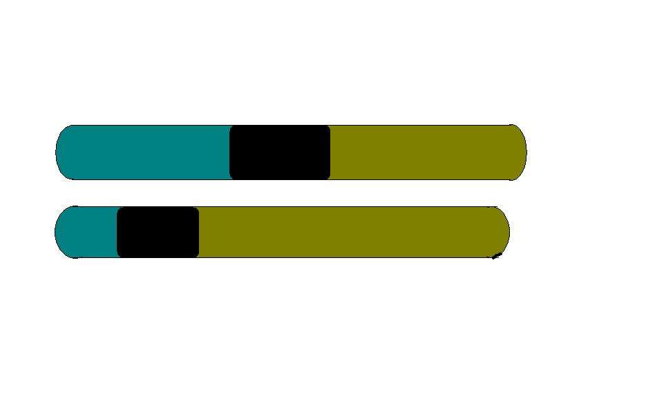

thanks spg, but ive got another idea. what if i were to place a plunger into the tank, and have it regulate the pressure as the pressure in one side increases, the plunger will move to prssurize the other side.
tarmann_90
Posts: 19
Joined: Sat Mar 31, 2007 10:57 pm
Tue Apr 10, 2007 10:14 pm
this way it could be like a spring, but you can change its resistance, and its cheaper. also you could take air from both sides
