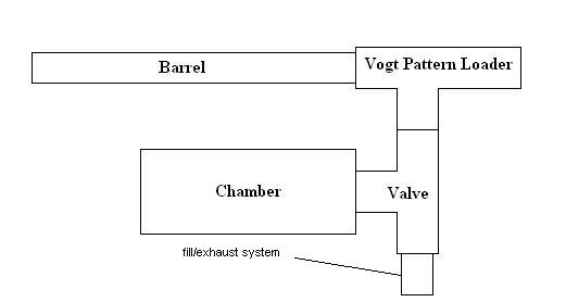

<img src="http://www.spudfiles.com/uploader/uploa ... LOADER.JPG">
You couldn't just arrange the cannon like this? If you are planning on submitting your cannon for the contest, then I will just find out what you mean when the time comes.
noname
Posts: 2698
Location: Bay Area, CA
Mon Apr 23, 2007 8:49 pm
Exactly what I can't do. The bottom of the valve and the fill/exhaust system would get in the way.
