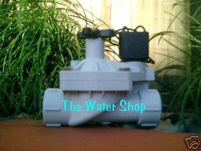

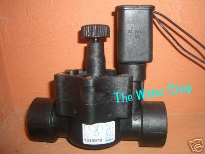

gday everyone. im going to buy my first sprinkler valve and im getting it off ebay. there is 2 options and im not sure which one to pick seeing as i haven't bought one before.
> I do want to mod the valve to be pneumatically actuated so id like to buy the easiest one to do this with. and it wont have more than 120 psi in it and both are rated to 150 or more (2nd one is rated to 175ish) psi
number 1 (white)
100% water tested
150psi (1050kpa) Rating
Engineering grade plastic body and cover, complete with 1/4" stainless steel cover bolts
Moulded shock cone reduces water hammer
Easily serviced without removal from installation
Voltage: 24 VAC
number 2 (black)
-100% Water tested
-Working pressure 0.4 bar (40kpa) to 12 bar (1200kpa)
-Made from high quality glass reinforced nylon
-Complete with stainless steel cover screws
-Moulded shock cone reduces water hammer
-Manual or automatic valve lever
-Easily serviced without removal from installation
-Low energy coil design 24 VAC
the white one looks closer to the ones i have seen on this site before i think.
so if anyone has any ideas thanks for helping. :)

frankrede
Posts: 3220
Wed Apr 25, 2007 6:54 am
both have guide rods so I wouldn't choose either of those two.

iknowmy3tables
Posts: 1596
Location: maryland
Has thanked: 3 times
Been thanked: 9 times
Wed Apr 25, 2007 7:39 am
you can't exaclly mod most valves at the solinod port, but the flow control stem often can make a nice place to make a nice deep port for the blowgun, but since its optional its usally cost more so I wouldn't buy it
I think the first one is better because It's flow design

rna_duelers
Posts: 1739
Location: G-land Australia
Thu Apr 26, 2007 5:54 am
They are just as easy to mod with the guide rod.All of my sprinkler valves have had a guide rod and they are POPE valves from bunnings.The first valve would seem more easily to mod as the material it is made from,it is more ridged and can more easily be threaded into and glued etc.
And price is another issue but both valves will not out perform each other significantly as they are all nearly based on the same principal of design.
