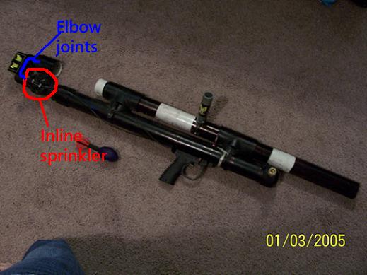

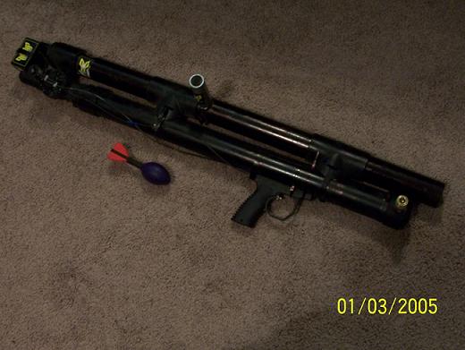

A full view picture of the cannon

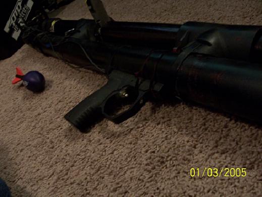

This is a modified trigger off of an old paintball gun. We used a momentary push button switch to activate the valve.

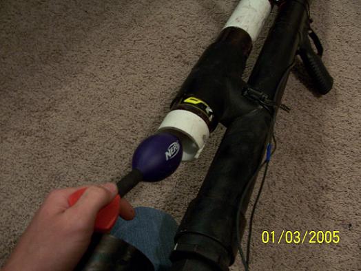

Breech open, we left some areas unpainted because it rubs alot in those areas and it would just take off the paint. It also acts as kind of a safety feature, letting you know that its open.
Loading a Nerf rocket into the locking breech

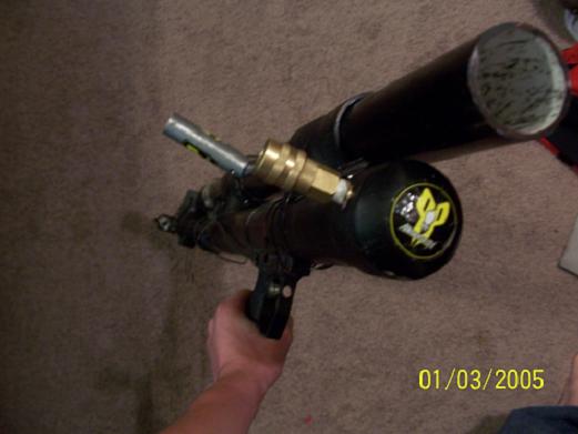

Here you can see the valve we use to connect the cannon to the air supply. Eventualy I will replace it with a check valve.

Pro, i think hes using a 1" sprinkler valve, it just blends in because of the paint.

Very nice cannon. Smooth, sleek, and looks good. Would this cannon happen to be inspired by the BECC? It looks strikingly similar.

Nice. I like bazooka style guns a lot. It looks like you used a U-shaped sprinkler valve. Did you?

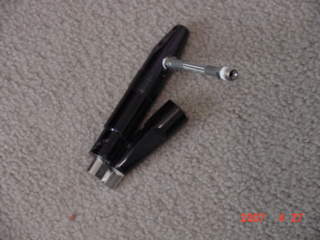

I like how you integrated the trigger, and you don't want to mod the valve, but you can look for those pistol-shaped blowgun valves. Your cannon will work better and still look good.

Flying_Salt wrote: It looks like you used a U-shaped sprinkler valve. Did you?
Nay,it is an inline valve with two elbow joints. Look closely at the n3 picture, picture used in my "diagram".

Looks like it might be 2" Pipe. Do you have a small portable way to quickly recharge it for multiple shots on the field?

Salt, those stains are where the fins of the football rub the barrel.They don't come out unless the barrel is sanded.
@Orpackrat,A nerf is 2" at the largest part of the bulb.The barrel would be a 2"
Overall SP, that is a nice gun.You could easily adapt that action to use cartridges.I've found they speed up loading.My first pneumatic was also inspired by the BECC as well as the "sniper" style.

Beautiful breech loader u have there. I like the way u didn't paint all of the barrel so u can tell when it isn't closed all the way. Great gun.

Thanks for all of the good comments. As for a way to recharge on the field, the only thing I have right now are portable air tanks, which hold enough air to last a while. Eventually I'm going to buy a regulator so I can run constant air, but for now I have to recharge it after every shot.

Man you need a regulator setup.I use a stock WGP Reg and it works just fine.Don't hook it up direct to the gun though,the output is 220psi.buy a tire chuck with guage and fill it that way.Also you might want to watch the quick disconnect on the side if you leave the chuck connected you might accidently shear the disconnect off the side. And finally pressure relief valves are neccesary.I hate having to put one on(another thing to hang up) but the way insurance is these days every owner wants to see triplicate of safety on homemade guns.Here is a pic to what my reg setup looks like:
Co2 regulating system.Just a spare WGP stock regulator preset to 220psi. I used some leftover ASA's to bring it down to 1/8&amp;quot;.The silver line attaches to a tire chuck with gauge.I have a quick disconnect coupler to plug into the gun and fill.
Co2 regulating system.Just a spare WGP stock regulator preset to 220psi. I used some leftover ASA's to bring it down to 1/8&quot;.The silver line attaches to a tire chuck with gauge.I have a quick disconnect coupler to plug into the gun and fill.
